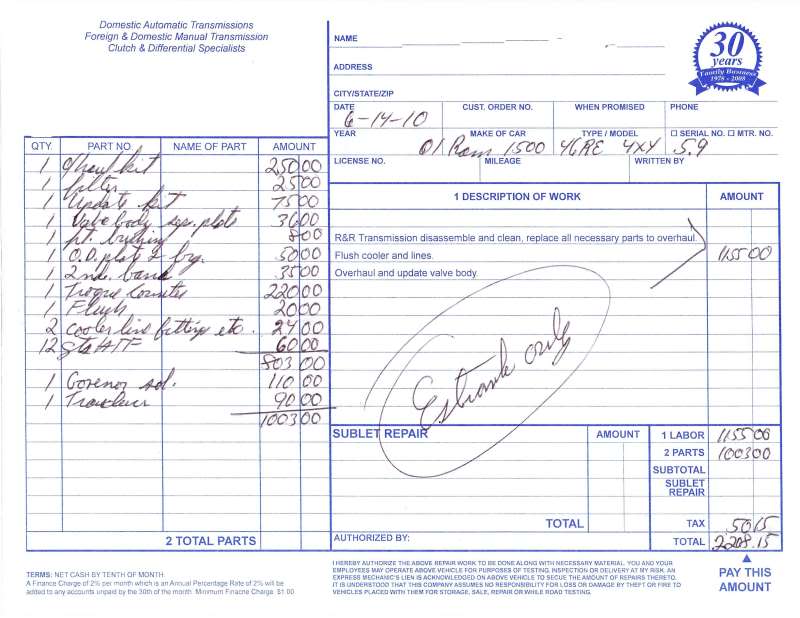

So I talked to the local shop today that a few local guys recommended. It's the only local one I've heard good things about. Anyway, I asked for a basic estimate and this is what he gave me. He told me it may change once he gets into it depending on what is going on. I told him I also want him to put another shift kit in if he can't re use my existing one, and that I will bring the fluid as I want ATF+4 and they say they use a multi vehilce fluid as they have had no issues. One other thing I told him I'm going to want done is I want the vent hole on the top plugged and relocated in case I go in water. I doubt I will, I just want to have it done in case.
So this is the parts list he gave me of what usually gets done. Does this sound reasonable? Anything else I should ask him to do?

BTW this guy is a local drag racer and builds a lot of transmissions for the drag racing guys from what I understand.

couldn't you just run that vent tube beside the A/C line through the firewall and seal it up so it'll be in the dash?
A friend of mine ran his air cleaner inside the cab on his jeep to keep water out of it and it works.

thats about what my rebuild cost was,,,

I followed MonteC's advice when I had mine rebuilt and the price came in under $2,000. I had the extra heavy duty shift kit installed, Borg-Warner bands, and the torque converter was rebuilt locally. The trans shop also advised that I install a transmission cooler, which they did.
I'm almost due for the 30K checkup, fluid/filter change and band adjustment. It's been a year and I'm hap-hap-happy!
