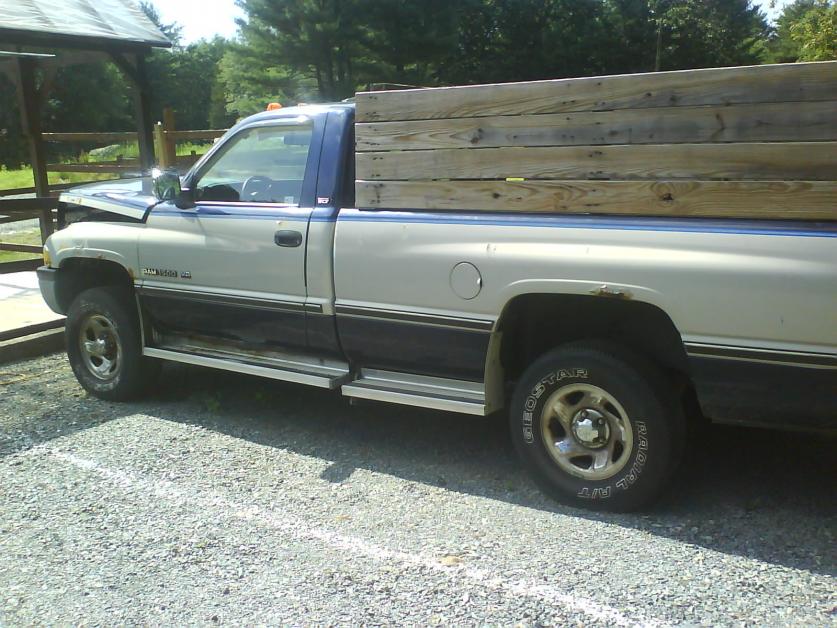

It's a 95 Dodge Ram 1500 4x4 5.9l. I bought it for $600 and a plow for $900. It's got 122,333 miles on it. It came with a new radiator that I'll be installing and I just purchased new front shocks for it and a new battery. I tried to get it started yesterday with the new battery so I could drive it home (it's located at my boss's farm) but it wouldn't start. It sounded like it really wanted to, but just couldn't. It has been sitting since last summer when he purchased his new Dodge. I'm sure it's a fuel issue and my buddy thinks it might be the fuel filter. What do you all think?
