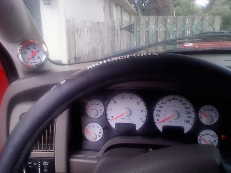

I was in the same boat. I have a custom ground cam in the box in my garage that is going in my truck someday. Only went ahead and got the pillar pod ahead of time cause my fat a$$ busted the factory one. When the cam goes in I want a multi-funcion gauge so I didn't want to spend a lot on my tranny temp gauge for the time being.
Picked this one up at Advance for all of $16. Matches pretty damn good and is backlit...
