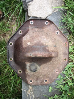

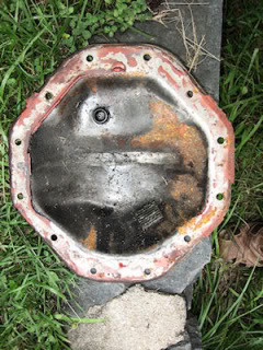

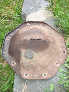

I'll take a few pics of the cover. It's different from most of the ones I'm looking at for a Ram 2500 PU.

I don't know if this helps but here's the cover.
The rest of the axel and housing are fine. If it's a Dana 70 or 80 wouldn't the only question be what the original gear ratio was?

Thanks for the link Beater. I see my cover now. Chrysler 9.25 12 bolt.
