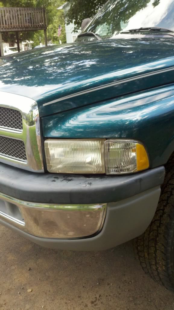

I just got through getting all the yellow off the headlights. I have to say it worked better than expected. Pics to follow.

here are the pics of the headlights. Passenger didnt turn out as good but it was the worst one. Im gonna go back over both of them in a couple days.
