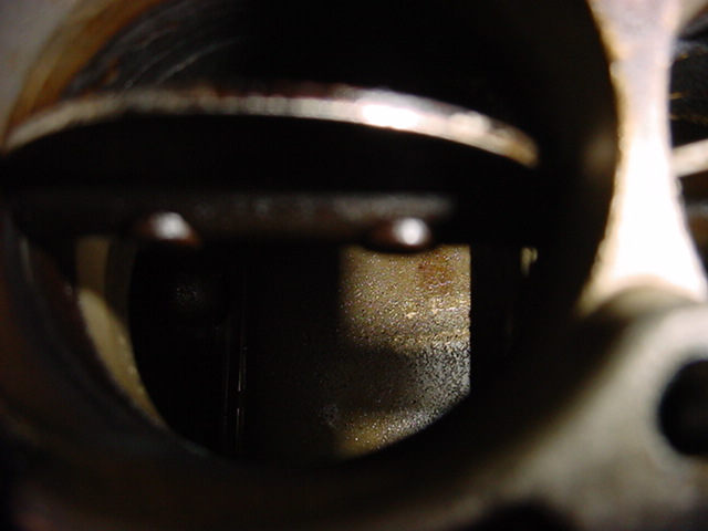

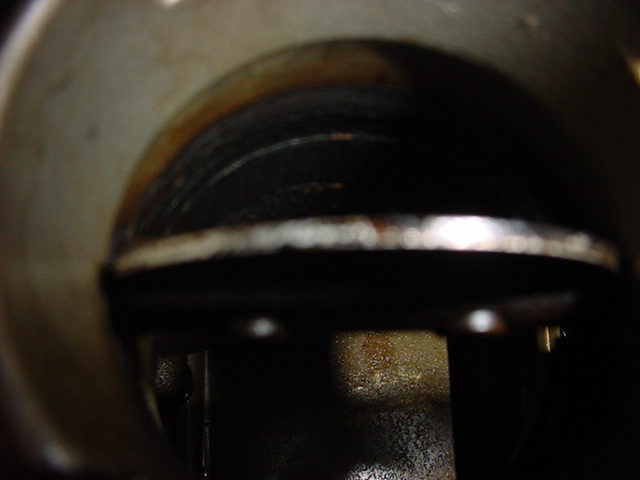

I climbed up and had a look down and I don't really see any significant sign of oil, there is just a thin film of moisture inside. I have never had to add a single drop of extra oil beyond keeping it changed every 5,000 km. Would the vacuum test confirm conclusively, I see conflicting opinions in other threads?
run the vacuum test on a fully warmed engine. See what it says.
Also may want to pull the throttle body, and look around in the plenum with a dentists mirror, or similar..... there does appear to be a bit of oil in there, but, that may just be from the PCV system.

As for the plenum test, I had my garage do the test as per the instructions and I do not have a blown plenum gasket.
