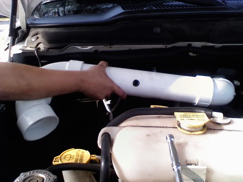

MAKE your own CAI, same net gains for $35-50 as a store bought one that can cost up to 10x more.
You'll spend about $15 on the PVC, boot and clamps and then anywhere from $20 to $35 on the filter depending on brand. PERFECT project for the "poor" college student.
You'll also get the satisfaction of making a mod yourself.
Just a couple I've made for guys around here:
what was used on top of the throttle body? this looks like what i want to do on my truck
I've just used a 3" boot with two hose clamps, but I've NOT done a 3.9, 5.2 or 5.9 yet. Have only made them for Hemi, 4.7, 4.0 I6s and GM 5.7s so far. If I remember how the TB was setup on my old 2nd Gen (it's been almost 8 years since I've had it) I believe the TB is setup a little different. Maybe someone will chime in who's either made one or installed a store bought on a 5.2 or 5.9.
This one is about $8 at my local Ace Hardware WITH the two clamps:
newcai1.jpg?t=1284559007
