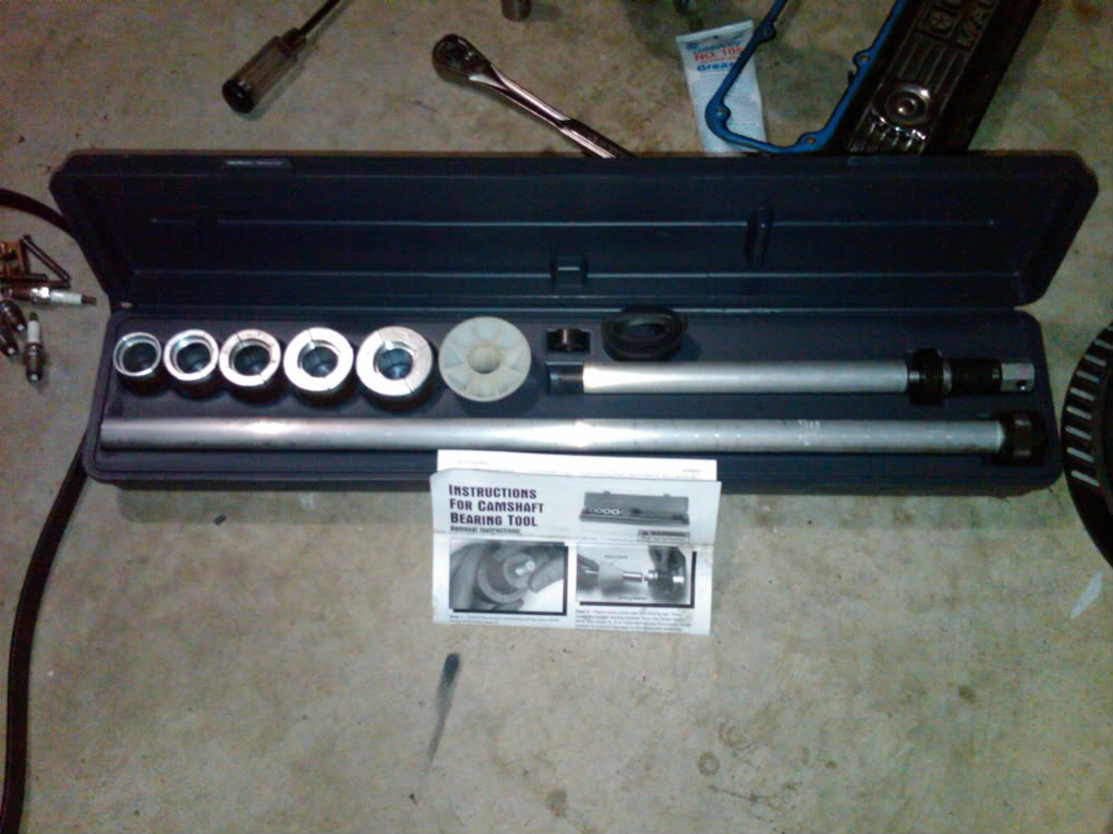

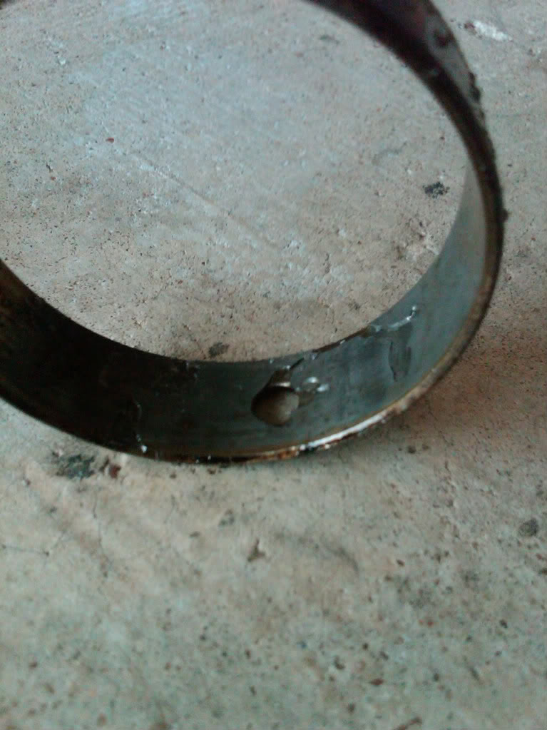

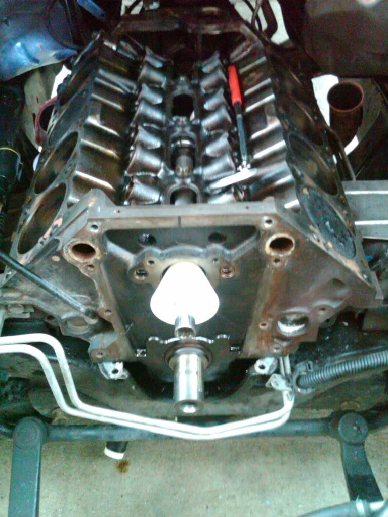

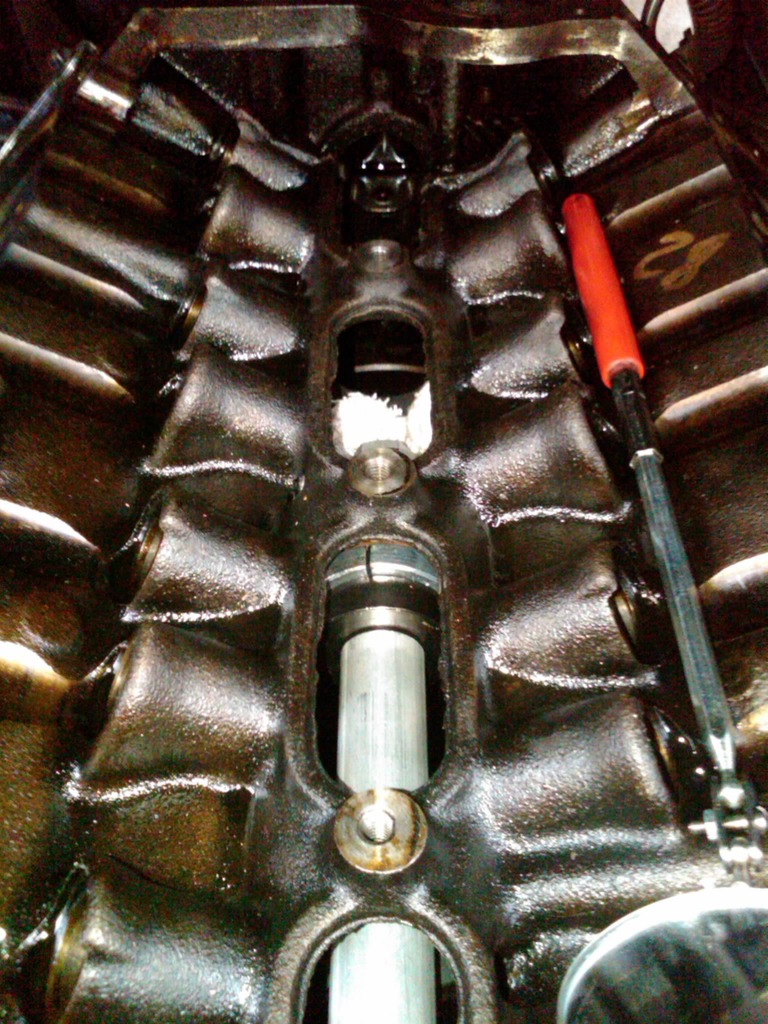

I had a bad bearing when I pulled my cam, I think due to some FOD that got in between the bearing and the jounal. Wasn't that bad of a change. The only one you really have to pray about is the last one in the back, gotta pull the engine to get that one out.
The cam bearings aren't that hypersensitive, you just go slow when pulling the cam and support the weight of it. Same for installation. Assembly lube will help cushion a minor "thunk". My advice is to get some all thread about 18" long (can't recall the correct size right now, take the cam bolt to the hardware store and match it up,) so that you can leverage the first journal to journal removal. After that, holding the cam is easier, remove the all thread and slide it out. You'll need to pull the radiator, but not the AC condenser to get the cam out.
Another option is to use some rope to act as a sling. Go back to the last 4 cylinders and snake the rope under one of those lobes and hold both ends of the rope up while you back the cam out. As soon as the cam bearing back out of the cam tunnel, the cam will want to fall, so be ready. Stop and rest your nerves when you get to each bearing on the camshaft. LOL
