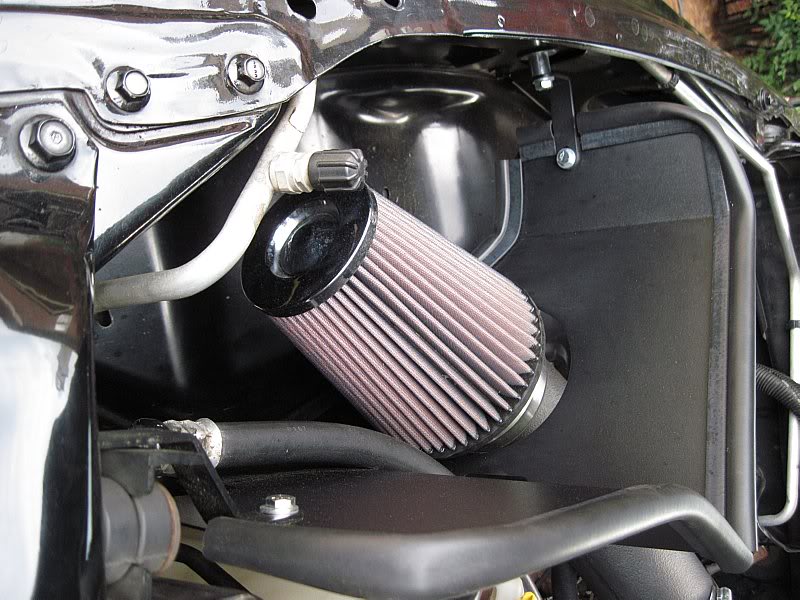

The S&B intakes do not make the same power increase as the K&N CAI. Which is minimal anyways, K&N makes about 9HP gain at 5400RPM.
The reason is cuz S&B pulls air from the stock opening in the pass quarter panel...same as stock location. K&N pulls air from the front of the engine bay in an open area behind the pass side headlight surrounded by large heat shields to create a good amount of space to pull colder air.

I don't care what anyone says...K&N has been proven to be the BEST CAI intake on the market for our trucks...however that comes with a price..paid $265 for mine. If you just want a cheap intake make it your self out of PVC plastic tubing or get the Spectre CAI for half the price of the S&B

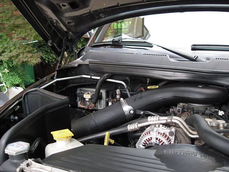

The S&B is great, it is priced less than the K&N and pulls just as much air. The hole in the fender well is not what makes the stock unit restrictive, and it doesn't make the S&B anymore restrictive than a K&N setup, not to mention it is pulling in cooler air. My Scangauge has proof of that.
Here are some pics of my S&B
To the OP, yes it is worth it, I noticed a nice gain in pulling power, as well as a 1-2mpg increase. They are a great company to deal with as well, I ordered mine directly through them. If you can afford another 40 buccs might want to look into a Volant.

I never said it was better, but it is priced better. Did I really get a 1-2mpg increase? Yes I did, I have a Scangauge2 to verify that my average highway mileage has increased, not to mention I also figure my mileage by hand on paper.
With the stock setup I was averaging about 15.5-16 with a city/highway mix.
With the S&B that has increased to nearly 17.5 city/highway mix
Believe it or not I can reach 20mpg highway fairly easily at 55-60mph, anything over 70 and my mileage drops to about 18.2 on the dot.
Keep in mind I have a Regular Cab/ Short Bed, 2wd with a 318, and my truck weighs roughly 4,450 pounds according to the local dump. So my results will vary from yours.
K&N is still the leader in cotton gauze filter setups, I won't discount that, I ran K&N setups on my MX bikes for years, but K&N always claims a pretty good horsepower gain, because THEY are trying to sell you something. Have an outside source do the Dyno run and you might be surprised you only gained .5- 1 horsepower (Same with the S&B). The main increase is just on the butt dyno. If you were to put both intakes on the same truck, and not tell either one of us which one was under the hood, you probably couldn't tell a difference between the two other than sound.
My Scangauge2 will also read the Intake Air temp
At 60mph I got the following readings
Stock Air Box- 145 degrees
14x3 edelbrock- 163 degrees
S&B intake- 123 degrees.
All of these temps were recorded in 100 degree Florida Summer. There is a slight gain to be had there. So it was worth it to me. I would love to get an IAT reading of the K&N FIPK.
