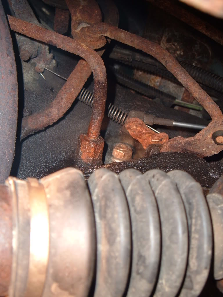

Old Oct 23, 2010 | 01:53 PM
zman17's Avatar
zman17
Retired Moderator - RIP
Posts: 18,729
Likes: 17
From: NH
That link assumes you are starting out with the factory set cable. So I gave him the factory setting link. It's very easy to adjust, if you look on the black plastic clip, you can see a mold seam that is centered on the socket. Unclip the white plastic clip and move the cable until that line is lined up with the metal ball on the TB lever. Make sure the spring is on the tranny end of the cable lever. You should be able to pull the black clip at the TB end of the cable and it should go back in when you let go.
