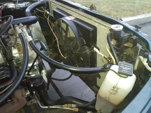

Originally Posted by BlueBeast2
The amount of CFM's our trucks need you pretty much need 2 fans. There was a thread a while back that said what CFM we needed but I forget what it is now.
I have dual Proforms 1 16" and 1 14" wired to a Summit dual fan relay kit. You'll need to wire up a 3rd relay for your AC with the summit kit though.
This was during wiring them up. All them wires are pretty much not seen now
My truck has only gone over 180 one time and that's cause I was stick in a field and not paying attention to the temps. Normal everyday driving they work great. I have noticed my headlights flicker from time to time not sure if that's from the extra power draw or not

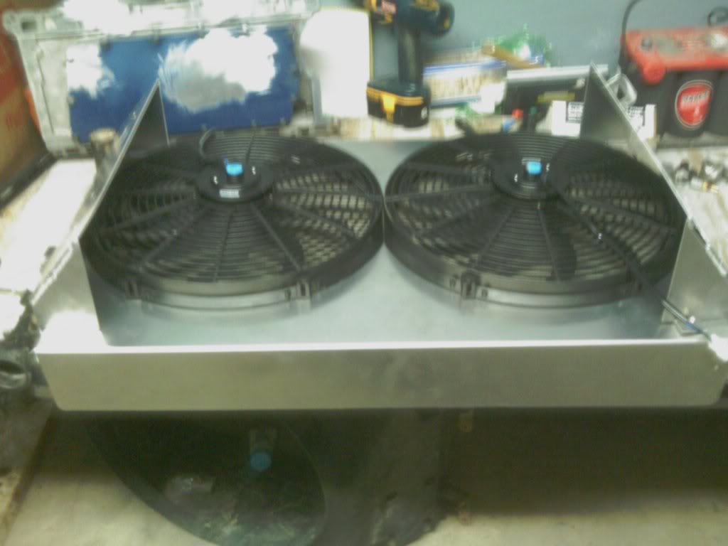

Default e- fans
2 x 2500cfm procomp fans ebay. tpc aluminum fan shroud. wired with a derale relay 180 degree turn on & toggle override + indicator light wired into +12v to fans.

Joey,
I have been looking at those fans on ebay for a while (TCP performance). I will probably get them in another 2 years after i put on the March 3 piece pulleys.
Call me old faishoned, but i like the idea of getting something with a full shroud.
Is this it?
http://cgi.ebay.com/ebaymotors/Dodge...item2a0b37e0f3
Old Oct 26, 2010 | 05:59 AM
Joey Buentello's Avatar
Joey Buentello
Joined: Mar 2008
Posts: 377
From: Texas
I bought the fans and shroud seperate, no fan controller that way but its cheaper.
