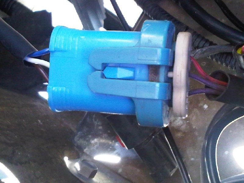

- My only complaints, and these are pretty minor, are that they could have made the harness about 2 feet longer which would have made it easier to mount the ballasts and route the wiring. Also the instructions could have been all in one place - I needed 3 or 4 more diagrams in addition to the instruction sheet. These are on DDM's web site, but there is nothing to tell you you need these until you start scratching your head and then go searching for them. One example is the pin-out or wiring assignment - the blue, brown, and white wires on the left were not plugged in when I received the kit, since it has the same parts for 9004 and 9007 types which have a different pin-out; the correct wiring is shown in the following pic:

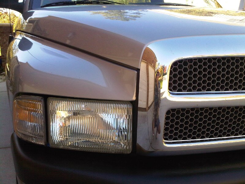

- I also used Meguire's plastic polishing kit to remove the scratches and yellowing from the headlight lenses. Worked like a charm, and I am sure Mother's or other kits would work as well. Here is an after photo (it is not yellow, that is just an artifact of the reflection of the trees in front of the truck):

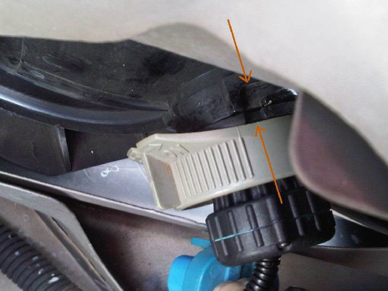

- One other thing to note: the lights go right into the housing if you line up the slot in the housing with the slot on the bulb holder (I didn't get that...):

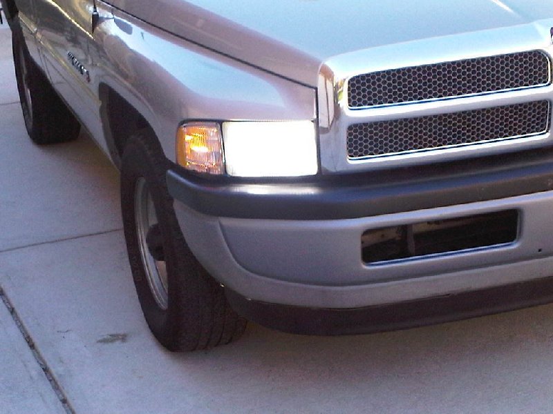

- All buttoned up:

If you are looking at new lenses to get rid of the yellowing or haziness, try the Meguir's or Mother's plastic polishing kits (polishing compound and a small buffing wheel). I did and it worked great.
