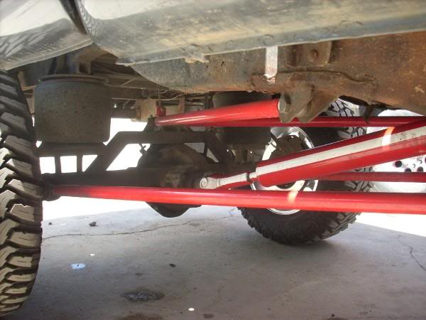

just an idea, here is what i did with my 75, all chromemolly heims, and they are semi bags, but they were free, so they got used, i have a small 12 volt, (pacbrake) compressor, there is a load valve in line, so it always stays at the set height no matter how much weight you add or take off of it, and with the trun of a screwdriver, i can set the rear bumper just a few inches from the ground, or get the bottom of the bumper somewhere around 5-6 feet off the ground where the drive shaft binds, but of course i dont do that, it stays at its set height, but it could be adjusted anywhere in between there if i desired
