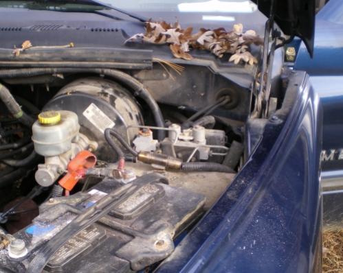

Opened the hood this morning and discovered one end of a heavy-gauge red wire hanging in mid-air. The other end is attached to a fuse-holder (containing a 30A fuse) mounted on top of a plastic case next to the battery, see pic below...
Engine still started and ran without it connected, and the other end of it disappears through the firewall into the cab behind the dash. I could only assume it had come off the battery + post, and so I have reconnected it, but nothing seems to have changed, whether it is connected or not.
I read the fault code this morning and it came up as 0128, which is the code for an O2 sensor, high voltage, cylinder bank 1, sensor 2.
Problem is, I have two O2 sensors, one before the cat and one after it, so which is sensor 2? I called the local Dodge dealer, who unconvincingly told me it was the post-cat one.
In the reply above, I see that pre-cat is suggested as being faulty.
So, I'm a little confused. Is sensor 2 pre- or post-cat?
I also checked vac hoses and they appear to be OK. I haven't yet removed the battery to access the cruise control servo unit.

Are you the original owner of the truck? I would say that power line with the fuse was probably going into the cab and powering some aftermarket accessory that may no longer be there.
