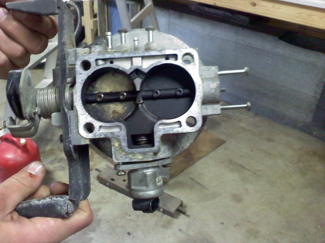

I have access to AllData, and I have a pdf of the 95 service manual, I cant find much about bad gas mileage in there.
I pulled my throttle body off, it is dark on one side and cleaner on the other, does anyone know if this could be a plenum problem?

If it hasn't been fixed yet, chances are good its blown. Fairly standard on these trucks.

That does look like the plenum is blown. I forgot to add that a blown plenum won't cause all of a sudden problems. It is more of a slow loss of power and economy. But if the truck is new to you then it will be very noticeable.

Hmmmm, black in the intake. Black Smoke. Seems like you are burning A LOT of oil. Plenum leak is there. Could also be PCV, because that would bring soot into your intake.
try 2 cans of seafoam, first can slowly at idle, then the second can while you pull the throttle a bit as you do it so you can get more to flow through the intake.
