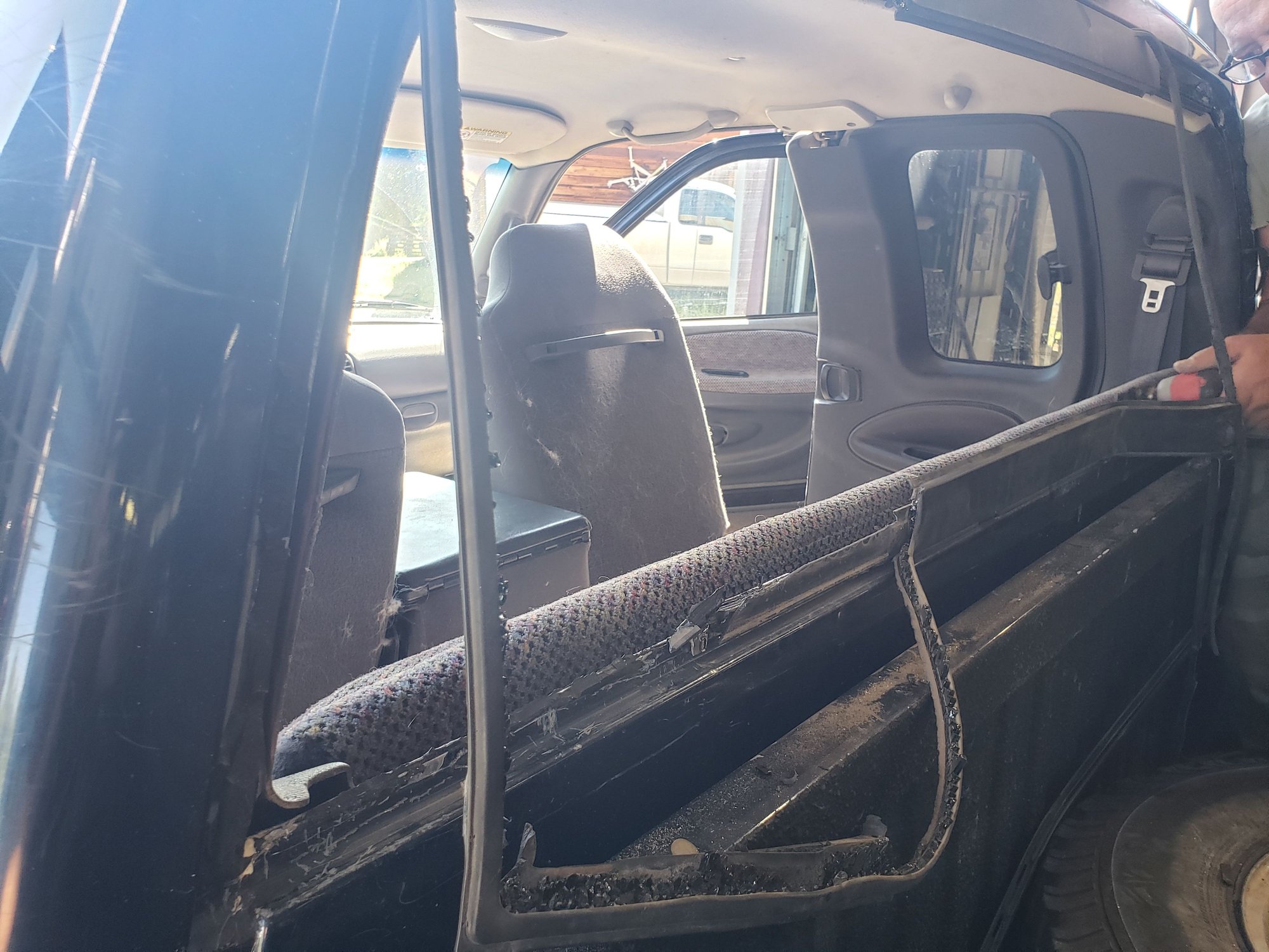

We busted the rear glass in a 2000 (glue in). I have a '96 (rubber seal) donor here.
If we get the back glass out of the 2000 (which I understand will suck per other threads here), I just want to super-extra-confirm the rubber seal version should fit? Posts above suggest they interchange, I'm just trying to be absolutely certain.
I find it unlikely (but not impossible) Dodge changed the sheetmetal around the window in '98??

Well the '00 is coming out. One of my helpers/volunteers is doing it but it sure doesn't look like fun. An OMT seems useful for removing the adhesive.

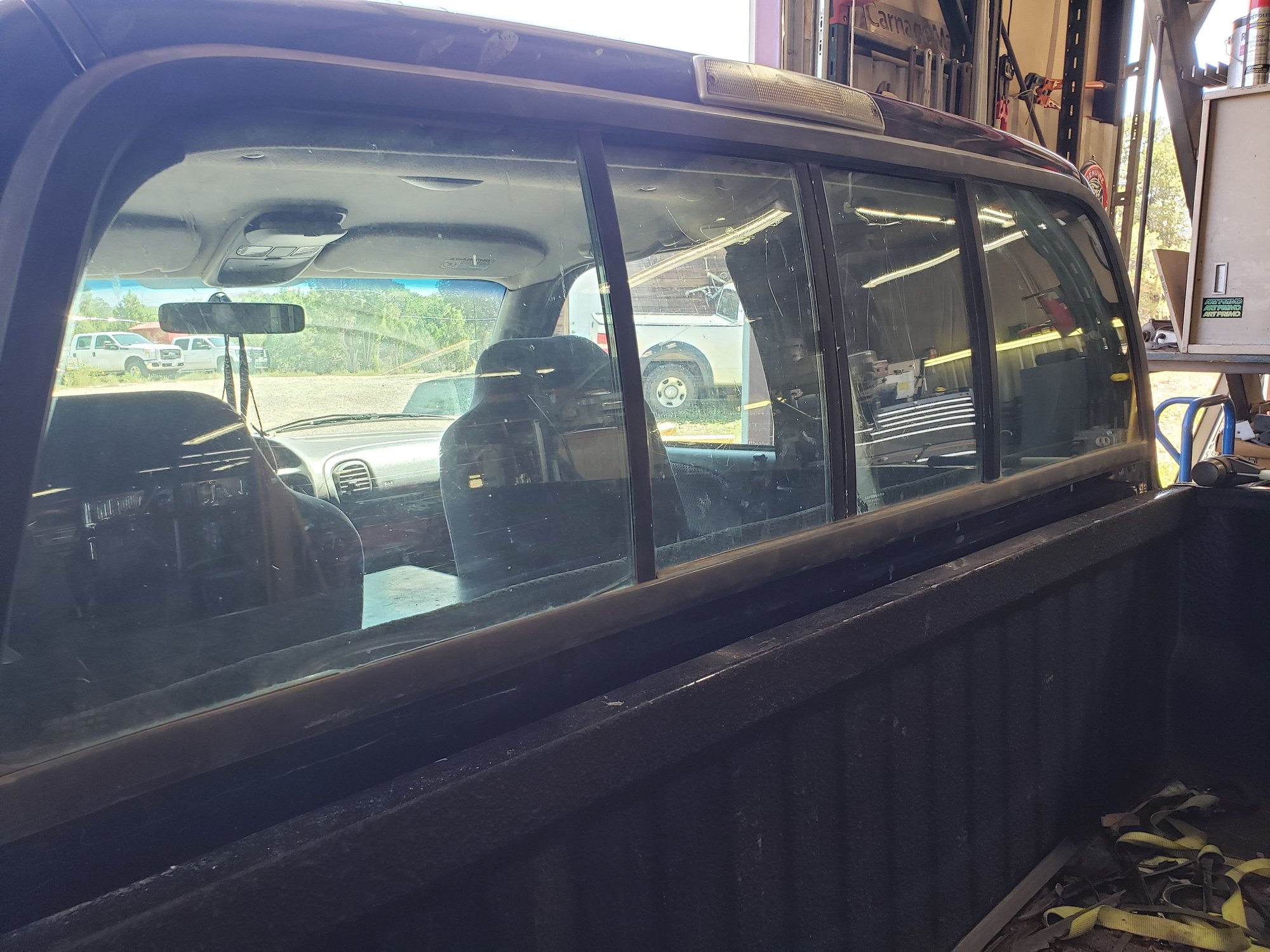

Here's hoping the '96 will drop back in. Looks like it should

Ok, the '96 glass fit with relatively minimal fuss
