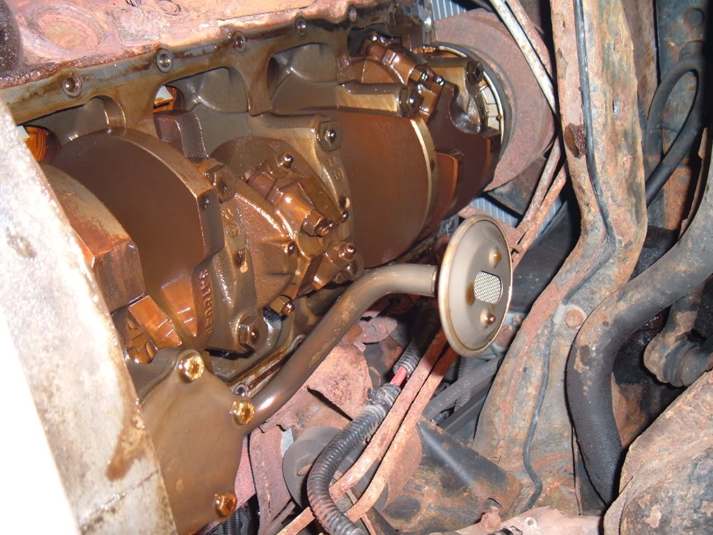

I can't wait for something better, so I'm getting the Spectra from advance. Just got done taking the old one off in an hour. I can't believe with all the rust down there, every nut and bolt came right off. And to top it off, the inside of the motor is so clean you could eat off it. Not a spec of anything on the screen and the rear main is not leaking.

You ought to try to push a finger through the spot you mentioned earlier for the picture.

Here is a pic of the inside of motor before I scraped and cleaned the gasket surface. I'll take pics of the pan itself tomorrow when I'm not so aggravated after putting the new one on! I don't think I will ever have to use conditioner in my hair(whats left of it) for the rest of my life. LOL
