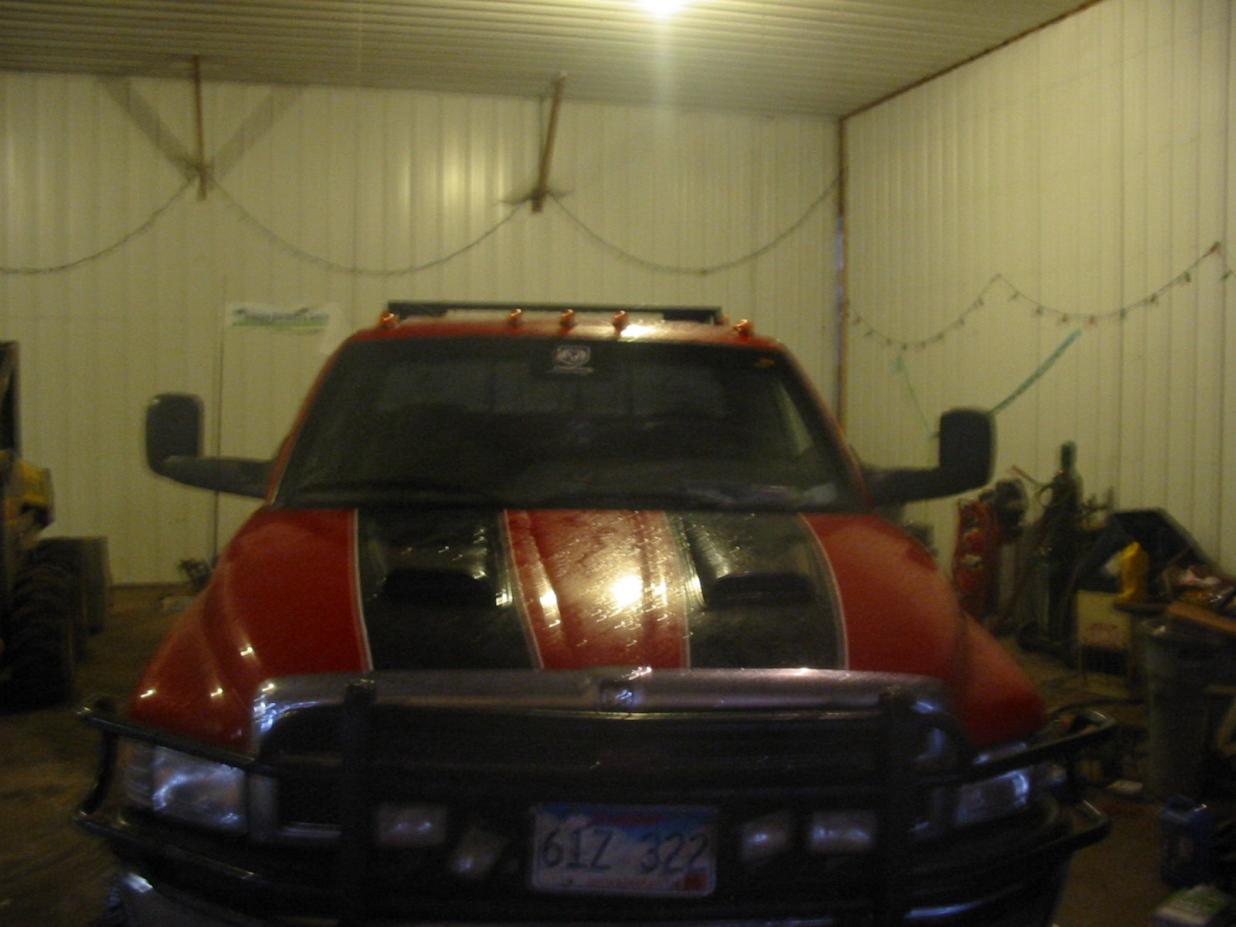

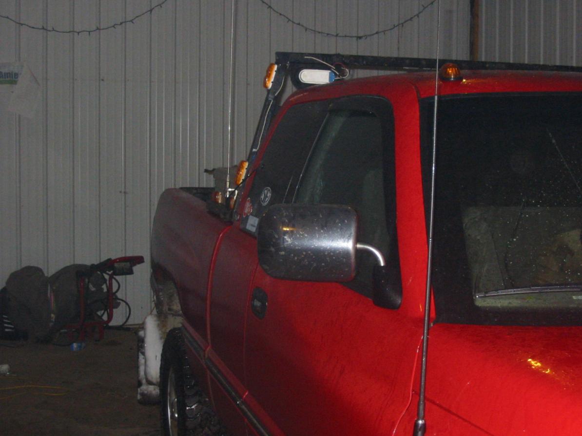

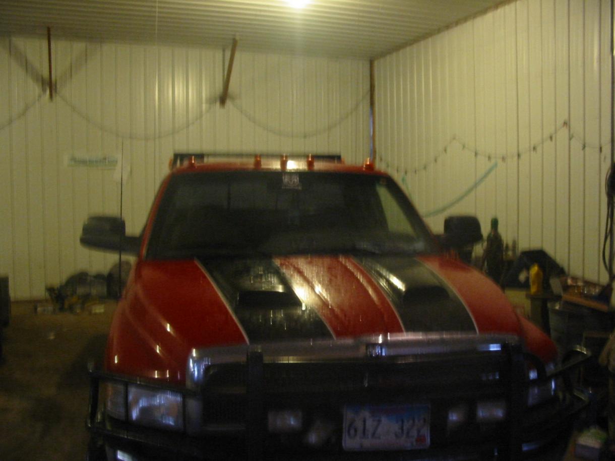

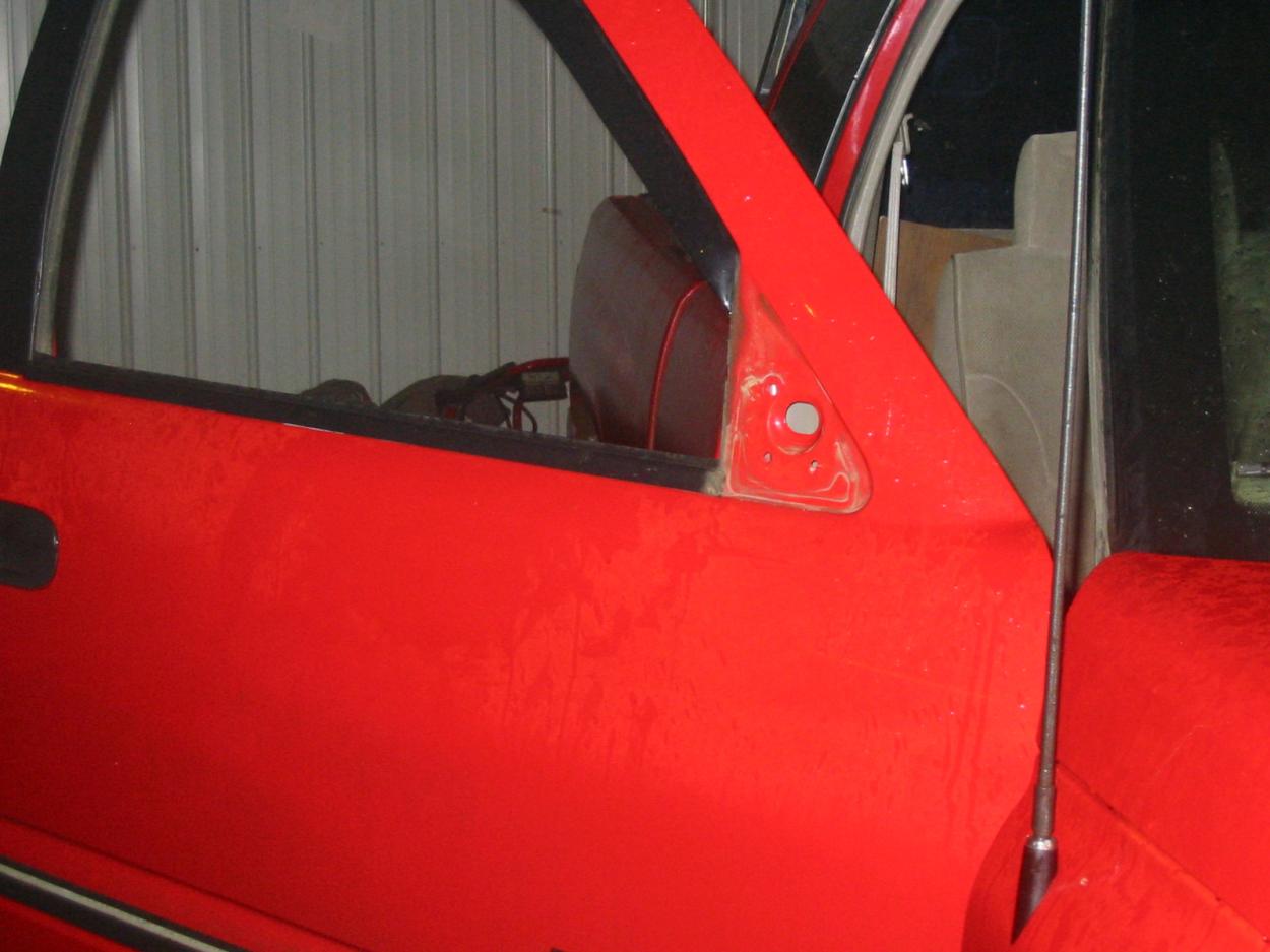

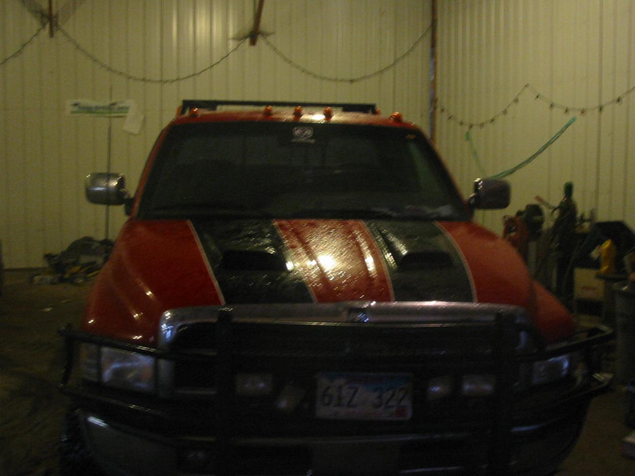

Well I got a set installed, they are 7x10 glass, and power for the 96, so everything plug and played. I did buy the reinforcment brackets since they were only 30 bucks for both from my dealer. For anyone wondering they make a big difference. I drove them for a week until the brackets came in. They shake a lot less with the brackets.
I really like them, so much nicer pulling a trailer with them. Also, they add a great look to my truck. I'll post some pictures soon as I get my camera to cooperate.

Here are some pictures
