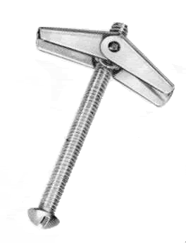

If you want to put it back on, get some toggle bolts.
Might even pull your dents out if ya tighten 'em up enough....LOL
