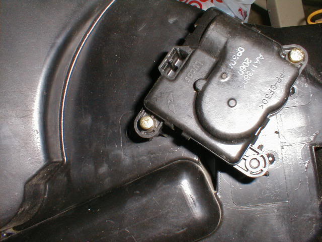

1. remove the blend door actuator on the bottom of the heater core on the passenger side it will come off with a flexible extension tool with a phillips bit, or a 90 degree screwdriver, but it will take longer, you have to pull the carpet back away from the firewall, and remove a little of the rubber padding, but it is pretty easy, the screw towards the firewall is B--- H,remove the electrical connector, make sure the truck is turned off ,after it is off of there ,you can manually move the blend door rod , rotate it and you will feel it go all the way one way then rotate it the other way, you will feel and hear a thump when the door closes all the way, start the truck warm it up and rotate it back and forth to feel the cold and then the heat, if it works correctly with GREAT heat , the actuator or control is bad, I can tell you later how to diagnose that, but try this first , if you are real inventive till it gets fixed you can roll tape on the actuator rod and tape it in the direction you want the heat, the rod only sticks out about 3/4 to 1 inch, so there is not much to grab, very common for the actuator to go out and not let the door go all the way closed or open, give it a try
