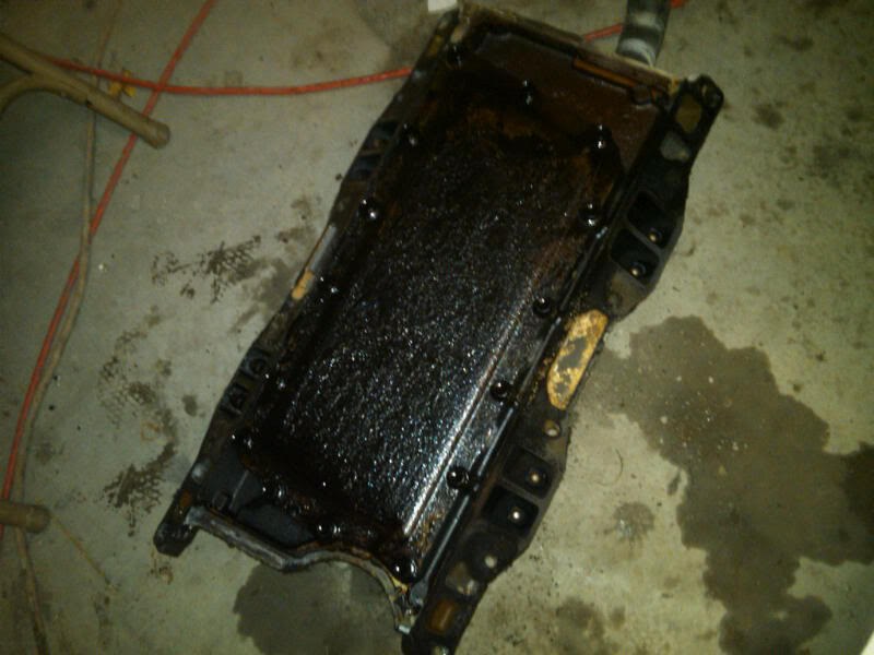

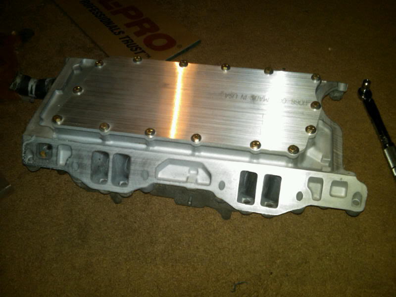

Finally got around to changing out my plenum pan and gasket. Along with that 180 degree thermostat, plugs, wires, distributor and cap, coolant temp sensor. The engine idles better but no more reaction from the pedal then i had before. It feels like a dog so i went and test drove a stock one from the lot and it kills mine with power. The plenum was blown so i figured i would have seen an improvement, what gives?
Also right after I did all of this my tranny shifts completely different then before. Now it has to sit at high rpms to shift, even at cruising speeds(dont know how to explain it) its got me worried. So how does any of the stuff i did affect the tranny? Is it a computer problem?
Here are some pics
Before

After

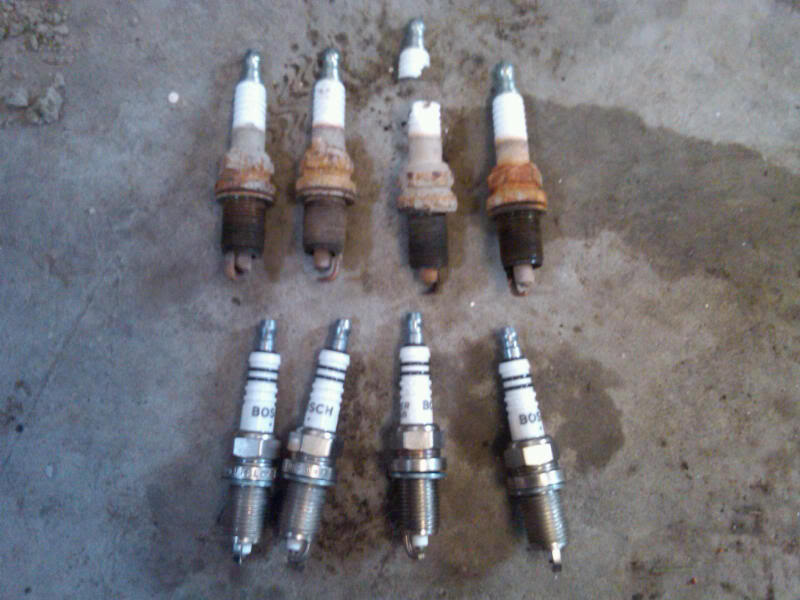

Nasty plugs

Its probably those damn Bosch plugs too. Get some factory Champions in there.

+2 for the Bosch plugs though. A set of Champions or NGK V-powers will last longer and help your truck run even better.
^Or NGK.
^Bosch plugs FTL. NGK V-Powers FTW.
