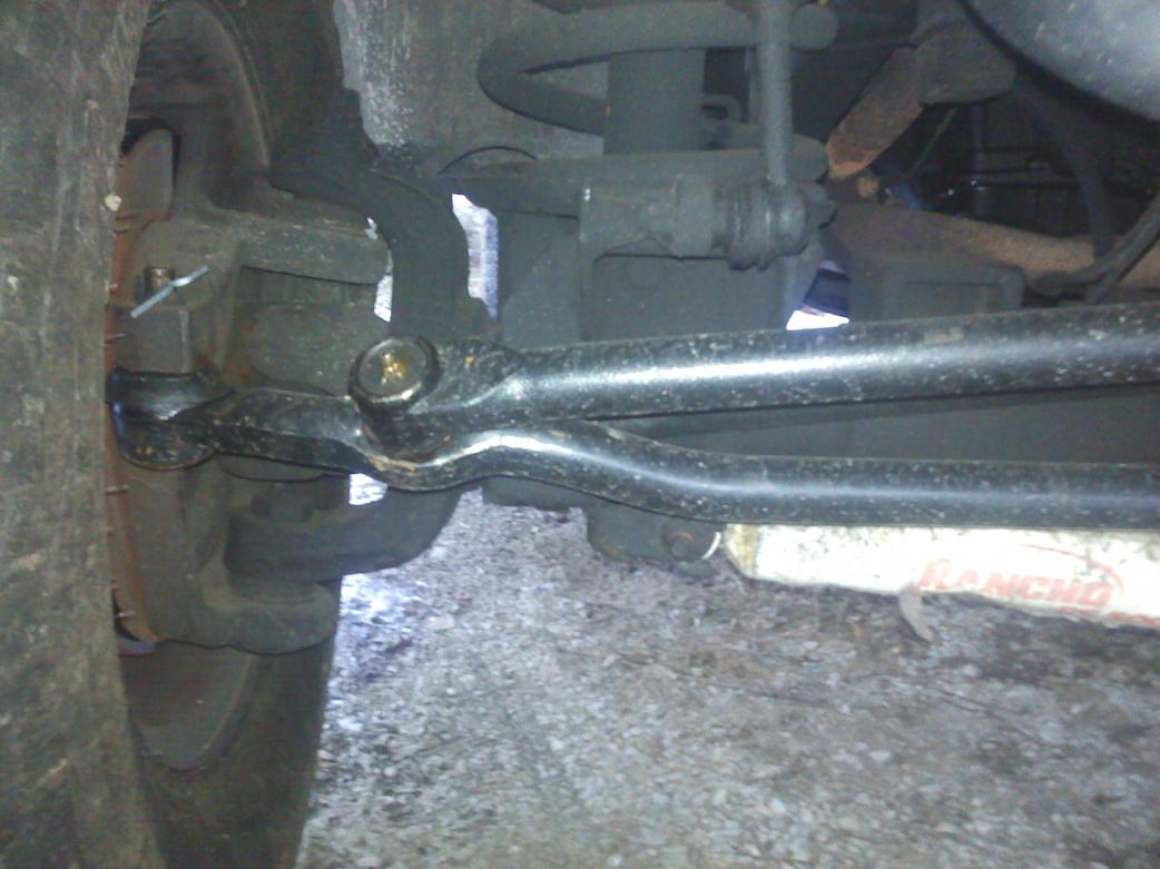

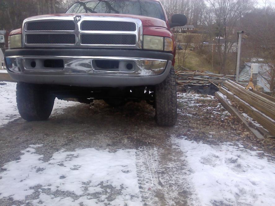

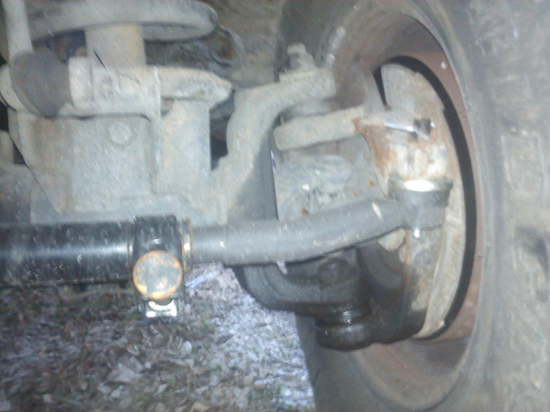

Thanks for the input. It may sound like a 2wd because 4wd drive is not exactly functional right now, but I explained control arms not control arm. Basically when my incident happened it snapped the pittman arm of the stearing gear box and bent the control arms. My driver side tire took the inmpact and moved the tire back against the body. I have replaced the gear box, the drag link, control arms, and all the tie rod ends. I am attaching pictures of the front and the left and right inside of the tires. The tire leans in front from the top on the driver side. I know that the ball joints need to be replaced but the tire position was not like this before. If you could look at the picture between the two tires I think that the knuckle is more bent in on the driver's side. I have not had an alignment done because when I took it to my friend because he did not want to charge me when something else was also wrong. I guess I am looking to see if there are interal pieces in the axle that can be replaced without having to replace the entire axle. Once again, any help is greatly appreciated and if I need to provide any additional information let me know.

From the first pic, it looks like the axle got bent......

Yep sure looks like the yoke and the end of the axle tube are bent upward a bit.

My guess would be bent knuckle and the noise you are hearing is from the ball joints binding. Could also be the axle, but usually the knuckle would go fisrt. Looks like you have a leak as well. Did that happen after the accident? Your best option is to take it to an alignment shop to be sure what is bent. It might be just as easy to find a good axle and swap it. That might be easier than than beating the hub off then you are still replacing the rotor. It would be heavier work to replace the axle, but it would be easier and probably quicker.

I would lift the front end and have someone spin that tire on the drivers side and you stand in the front and look at it to see if it wobbles. It looks like you knuckle or axle is bent.
