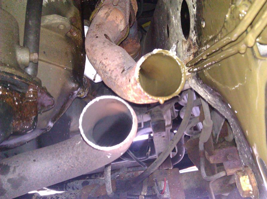

im wondering if the oil pump failed it would cause this!
Old Feb 12, 2011 | 02:31 PM
Posts: 87,453
Likes: 4,218
Failed oil pump would make some serious racket before the engine let go. You would also get some indication on the gauge in the dash. (not to say it isn't toast now....) Find out where your oil is coming from. Post Pics.

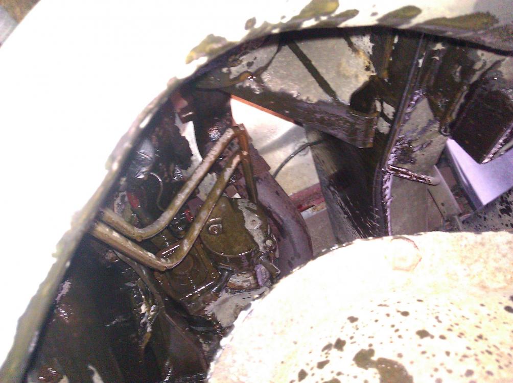

Default pics of my disaster
looks like one exhaust pipe is totally dry!
Attached Thumbnails 99 dodge 1500 won't fully start-img_20110212_144550.jpg   99 dodge 1500 won't fully start-img_20110212_144453-1-.jpg

Wow, I bet the cat is still blown though

i'm sure the cat is a little water logged, but that's the least of his problems.
that oil looks a little more like an oil/coolant milkshake than just pure oil, and combined with the banging and the lockup, it might be ugly.
