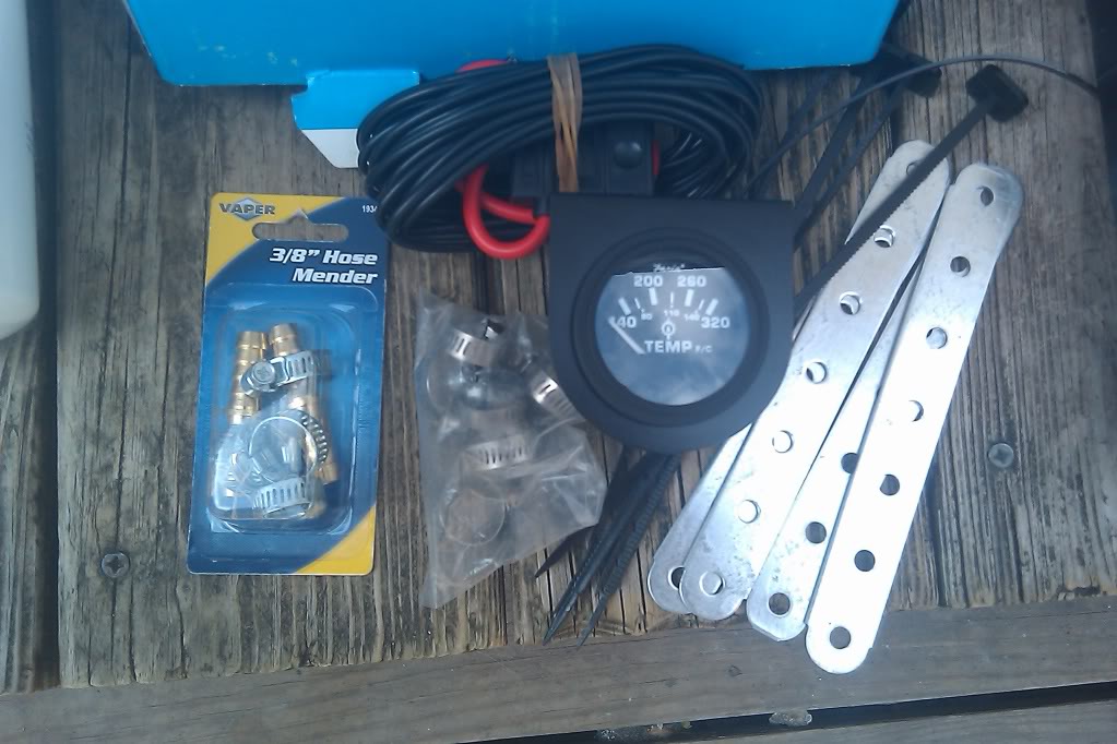

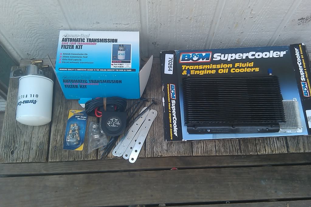

Perma-cool remote filter and guage
B&M 24,000 gvw aux cooler
3/8's hose coupling
to make thing easier i made sure the trans fiter and cooler both had 3/8's fittings before i order either one from summit. all in all it cost me close to $180 with shipping

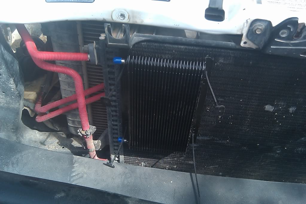

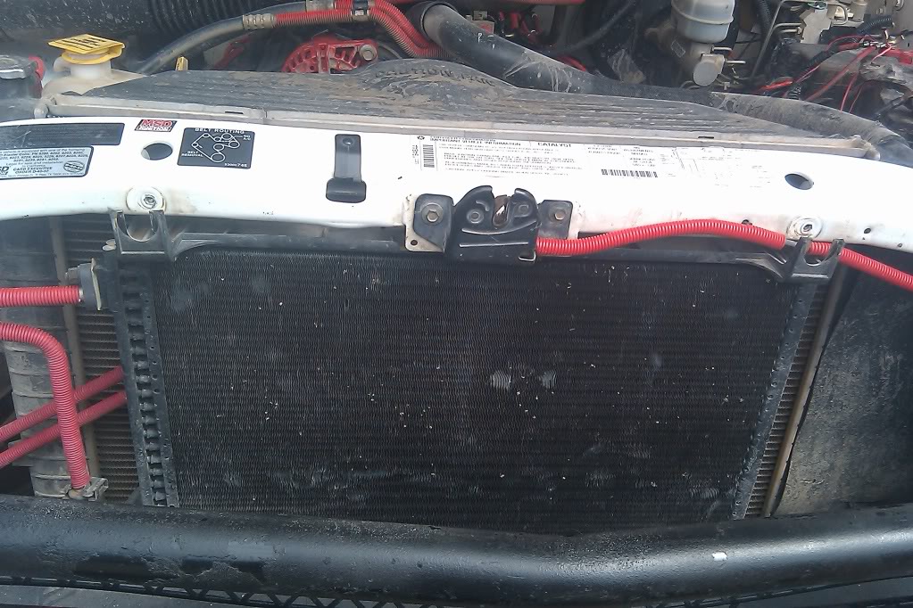

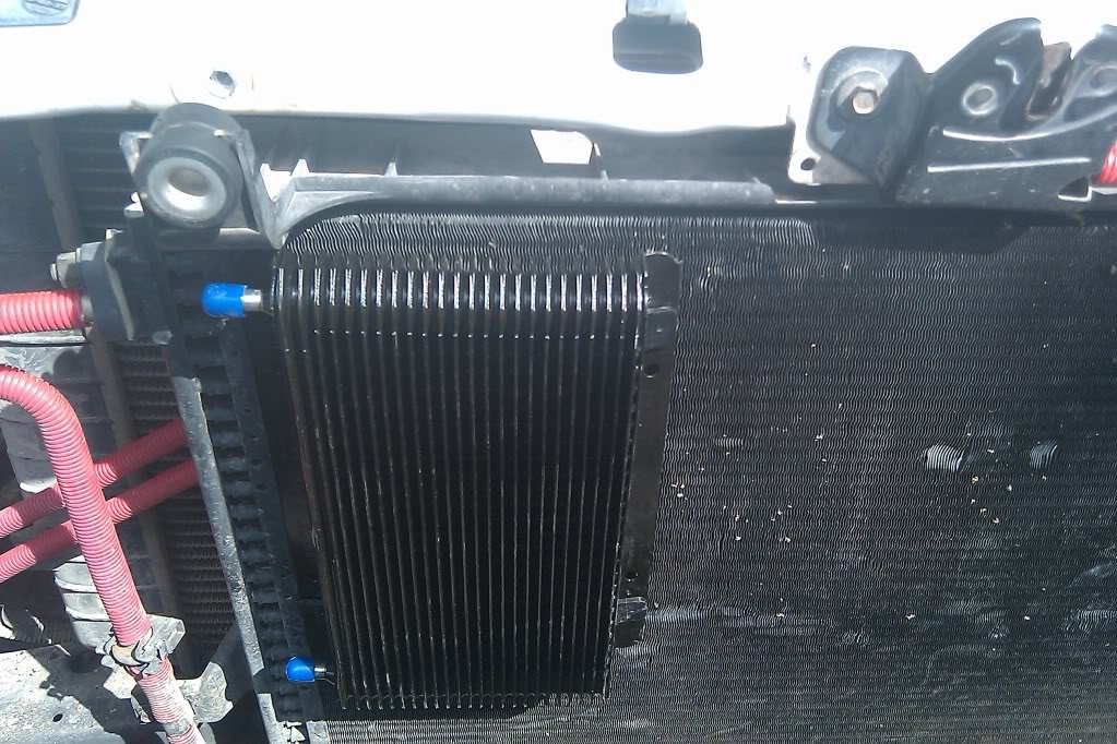

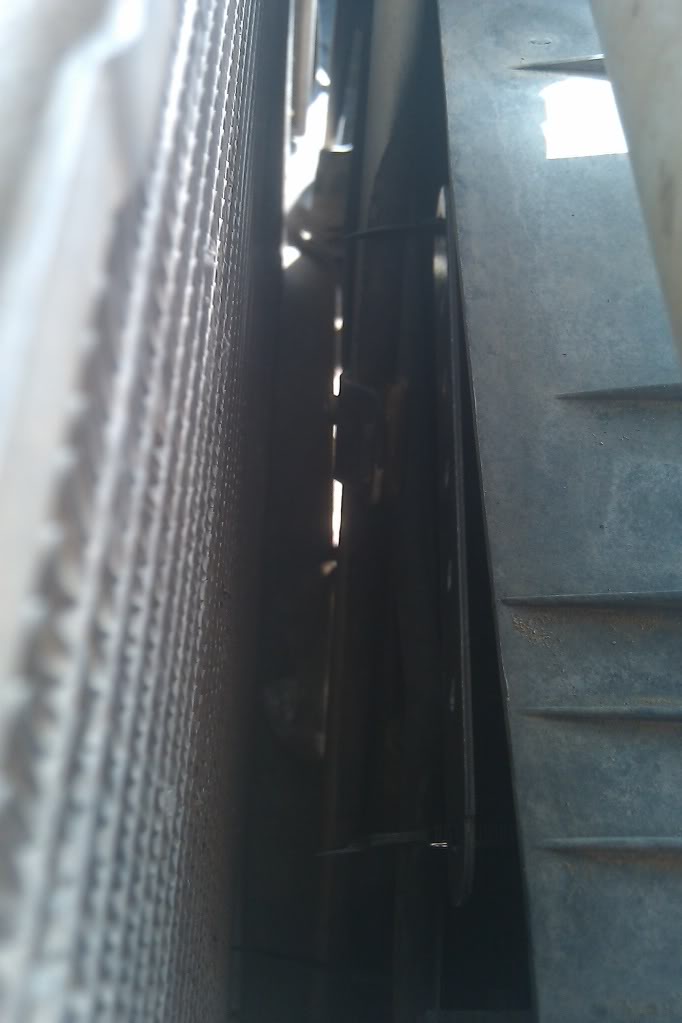

then i found a suitable location for the super-cooler, and mounted it with the "zip ties" through the condenser with the aluminum strap behind it, to insure they dont rip through! the third pic, is behind the ac condenser

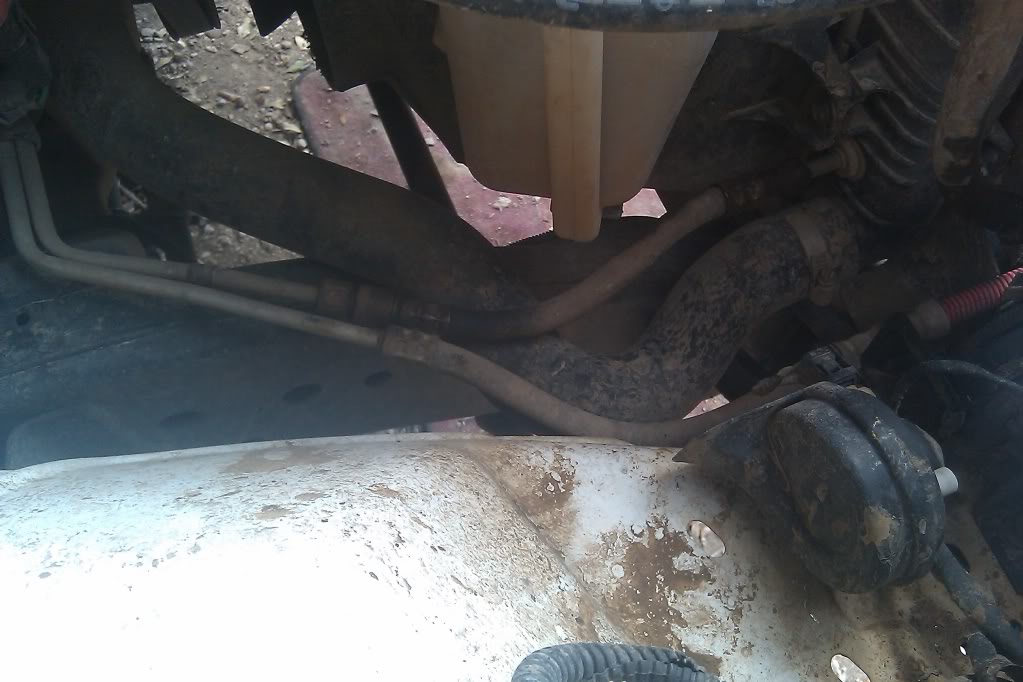

then it was time to cut and splice the the factory trans lines, one of the packages came with a fitting that fit where the check valve was so i deleted that while i was at it
stock
aux cooler

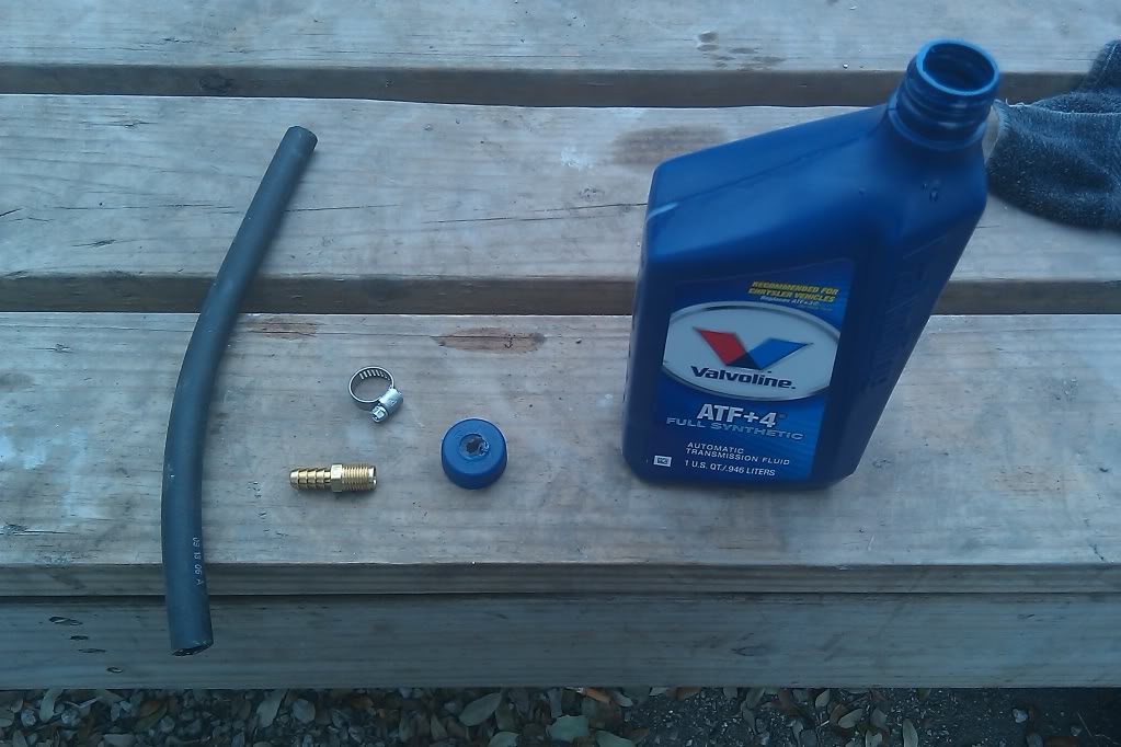

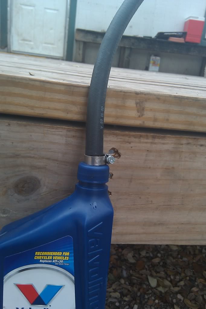

i then filled up the filter and cooler with trans fluid prior to starting it, i wanted to avoid the whole dry start thing, anyways i made this little tool with some left over parts to help me out.

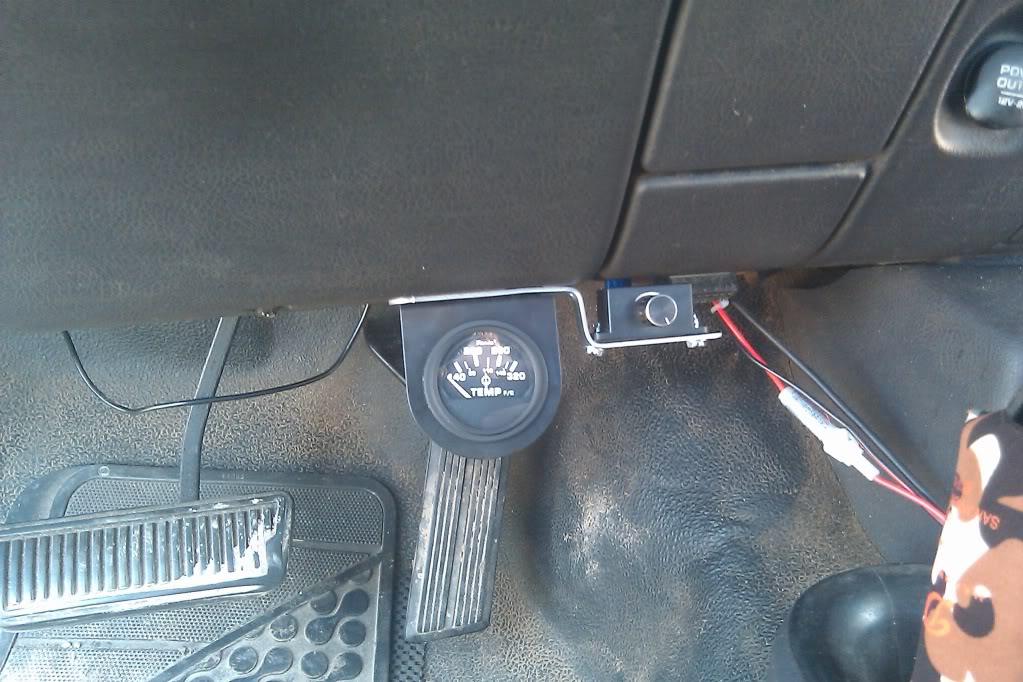

i then mounted my gauge in the cab above the gas pedal. i made this little bracket to hold the gauge and my bass ***
so far i have the gauge wired up but every time i hooked up the illumination wire or the gauge ground the gauge zeros out, so im gonna have to go over the wiring and diagrams.
on my way to work earlier i noticed the temp didnt get over the 140* mark
3/8's hose coupling
stock
aux cooler
