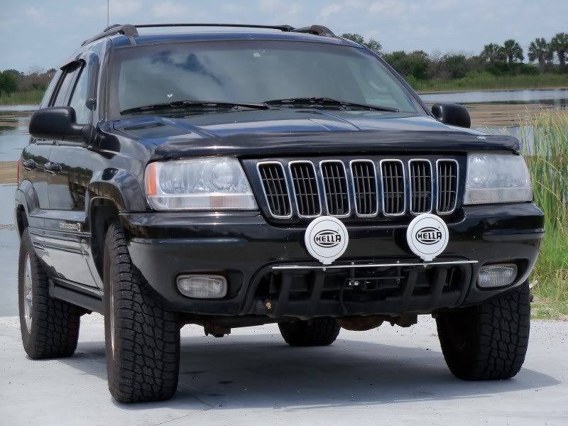

One thing to be aware of though, I think the meanest front receiver mount I found was rated at 9000 pounds. Really easy to exceed with even a wimpy winch, and a ****** block......
That's actually not bad, I forget what the factory rear hitch was on my 2nd Gen, but the early 3rd Gen 1500s (2002 and pre-11/02 built '03s) were only 10k. Later they became 12k lbs.
Originally Posted by BamaRam97
This one maybe just what you are looking for and it is compatible with Warn winches. I can't find the load rating on it though.
I have the Warn front receiver hitch on my Grand Cherokee and it's rated for 9k rolling load weight. I would have to assume that the Warn front mount for a Ram would be higher since the Grand Cherokee has a Unibody frame...

Oh yeah, you lose a good bit of angle of approach, a big concern for a serious off-roader with a non-lifted truck. Mine is really hampered with the roller fairlead and 130 watt lights mounted out front of, but my Grand Cherokee is my daily driver and the winch was a "hand-me-down" when I stepped into an almost too good to be true deal on the one that is currently on my Ram.
The winch and cradle live in the back of the Jeep and only gets put on when I use the Jeep to go fishing or camping. Hog/deer hunting/etc. is all done out of the truck anyway.
A nice thing about having a front receiver hitch is that you can put anything on the front of the vehicle that you can weld a 2" square pipe to. I made my own light bar for when the winch is not on and am currently working on welding up a rod/tackle holder for surf fishing.
