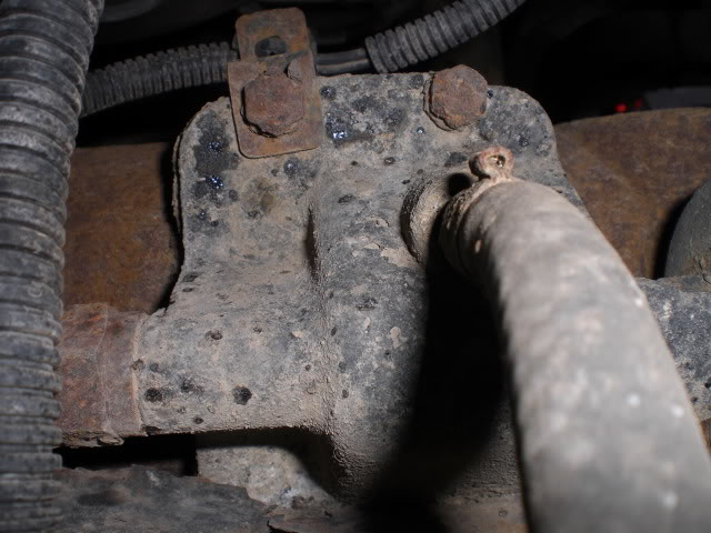

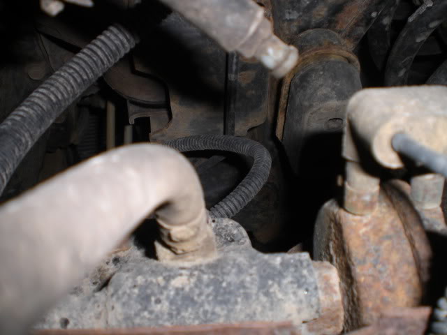

so i was under the truck and found this hose laying on top of the pass. side cv shaft and i dont know what it connects to. in the firs pic shows the hose and the other two show it connection to some actuator or something connected to the pass. side front axle in between the diff and cv shaft.
The hose is at the top of the pic

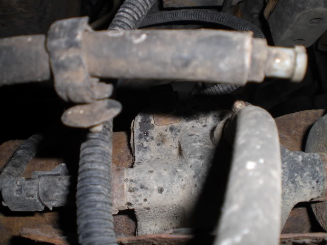

In the last pic shows the hose again at the top of the pic

thanks for your help I cant leave it hanging down their and I dont know what to do with it
Old Mar 31, 2011 | 09:46 PM
Posts: 87,399
Likes: 4,214
Front axle vent hose. Just make sure it is up high and dry somewhere. That end doesn't connect to anything.

That hose runs up the inner fender under the PCM and snaps in. The plastic button must be broken.
