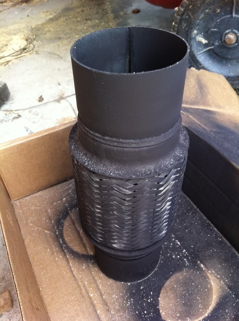

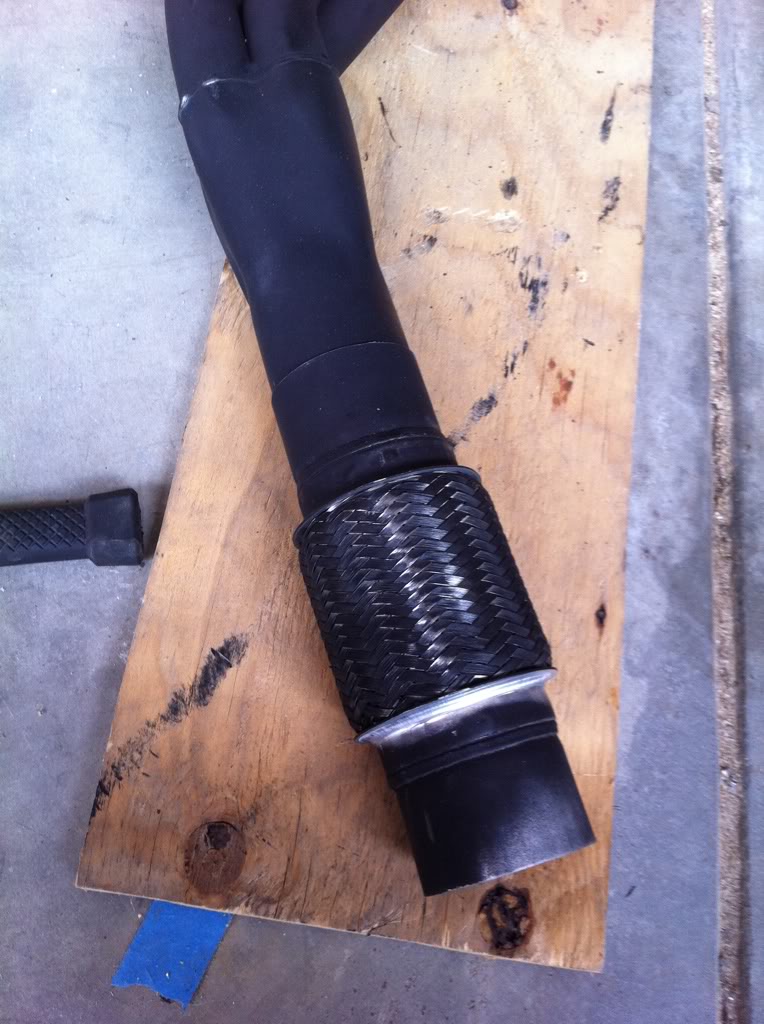

I got the pacesetter long tubes and pacesetter 3" Y pipe, just moved the cat (new magnaflow) to behind the Y. added some cherrybomb flexpipes to keep the headers from cracking. ratchet straps not required. not sure what size your collectors are though.

That is the same setup i like todo. Bet it sounds wickde. Can i see some pictures of the y-pipe flexpipse thing your speaking off or heck the headers to hahahaha?

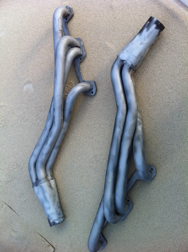

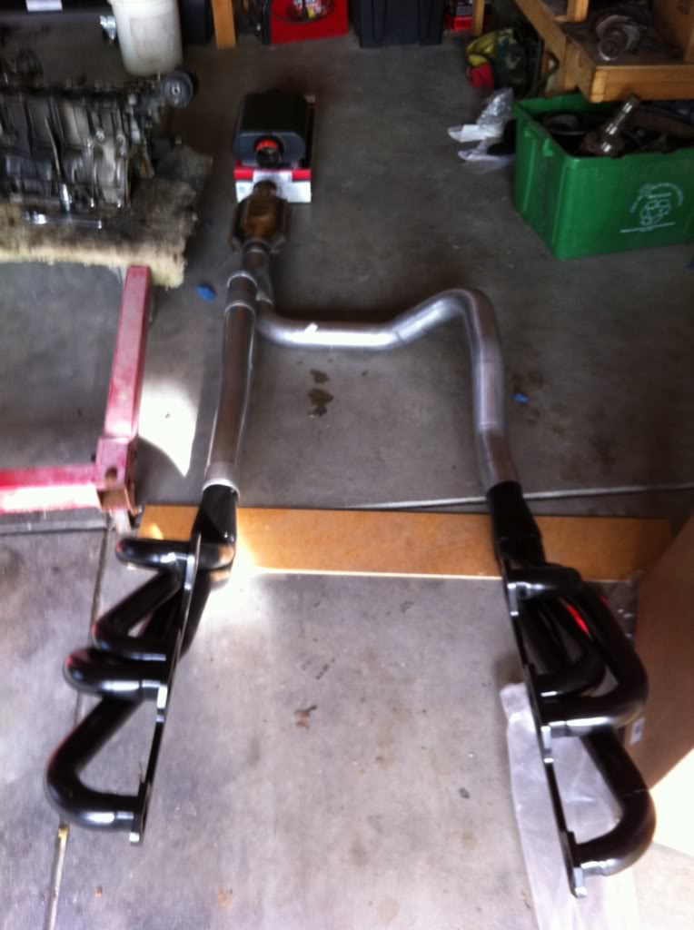

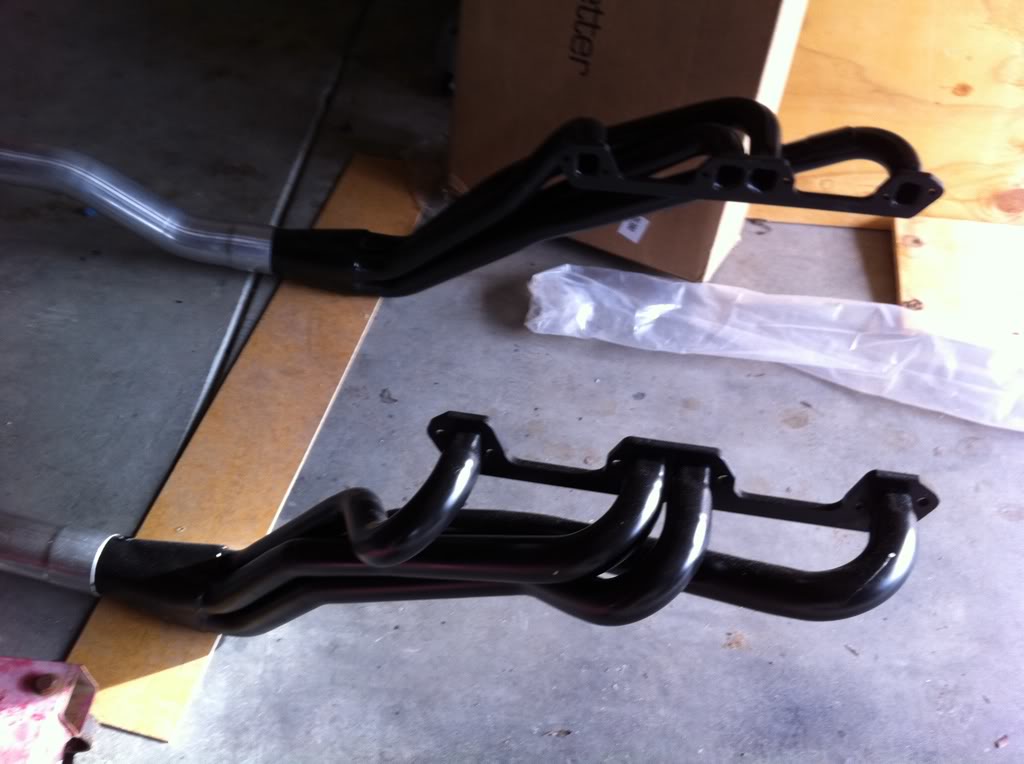

heres my setup on the shop floor, making sure I have enough pipe and all the right connections. I sandblasted the headers and gave 'em a good VHT paint job, black. I did have to buy and weld an O2 bung, I got a 2 pack off ebay for under $4 shipped. Oh and the flexpipes arent on the mock up becase it kept falling over but they were $20 at Summit. Cherrybomb brand too. also would up spraying VHT on everything including all the pipes and muffler. only exception was cat, and it was the pretty chromie from Magna.

from what you see, basically got a 4" pipe from Summit, $17. cut it in half to go from the cat to the Super 44, then the other half straight back and dump out. great performance and good for the environment (Im reducing emissions with my cat, are you) and easy for the checkbook.
Edit: I just figured it out, spent about $650 total for the exhaust, to include everything from the headers back, parts, shipping, clamps, paint, and sand to blast the headers.

Thx for the pic thats sweet set up some reason thought had them installed. Want to get this but that dam hunny-do-list comes first. ROCK ON

super clean setup im looking to buy a set of pacesetter headers like those. were they difficult to install ? an u said u purchased flexpipes also.. what are they used for ?what do mean by headers cracking ?

The welds from the primary tubes to the header flange can crack under heat/stress, especially if there is any tension on the headers. The hardest part about the install was getting the old one off. I ended up cutting about 3 places and unbolting the hangers to get it out.
This is from my initial install, I currently have the truck back apart for main and rod bearings and rings + heads, intake mod, and plenum fix. I only had the exhaust on there for about 2 weeks but it sounded awesome. Ill post more pics in about a week or so when it all goes back together.
