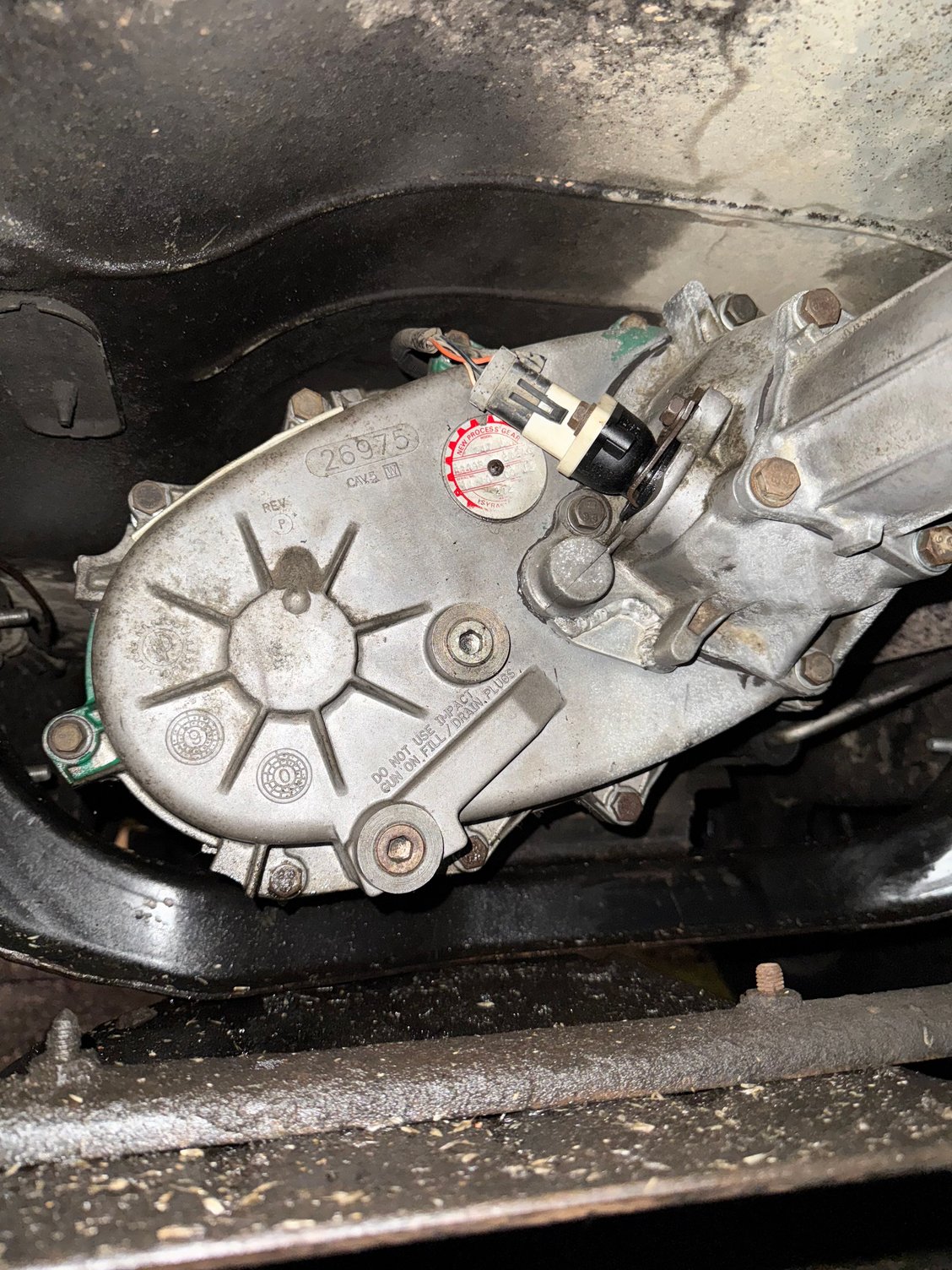

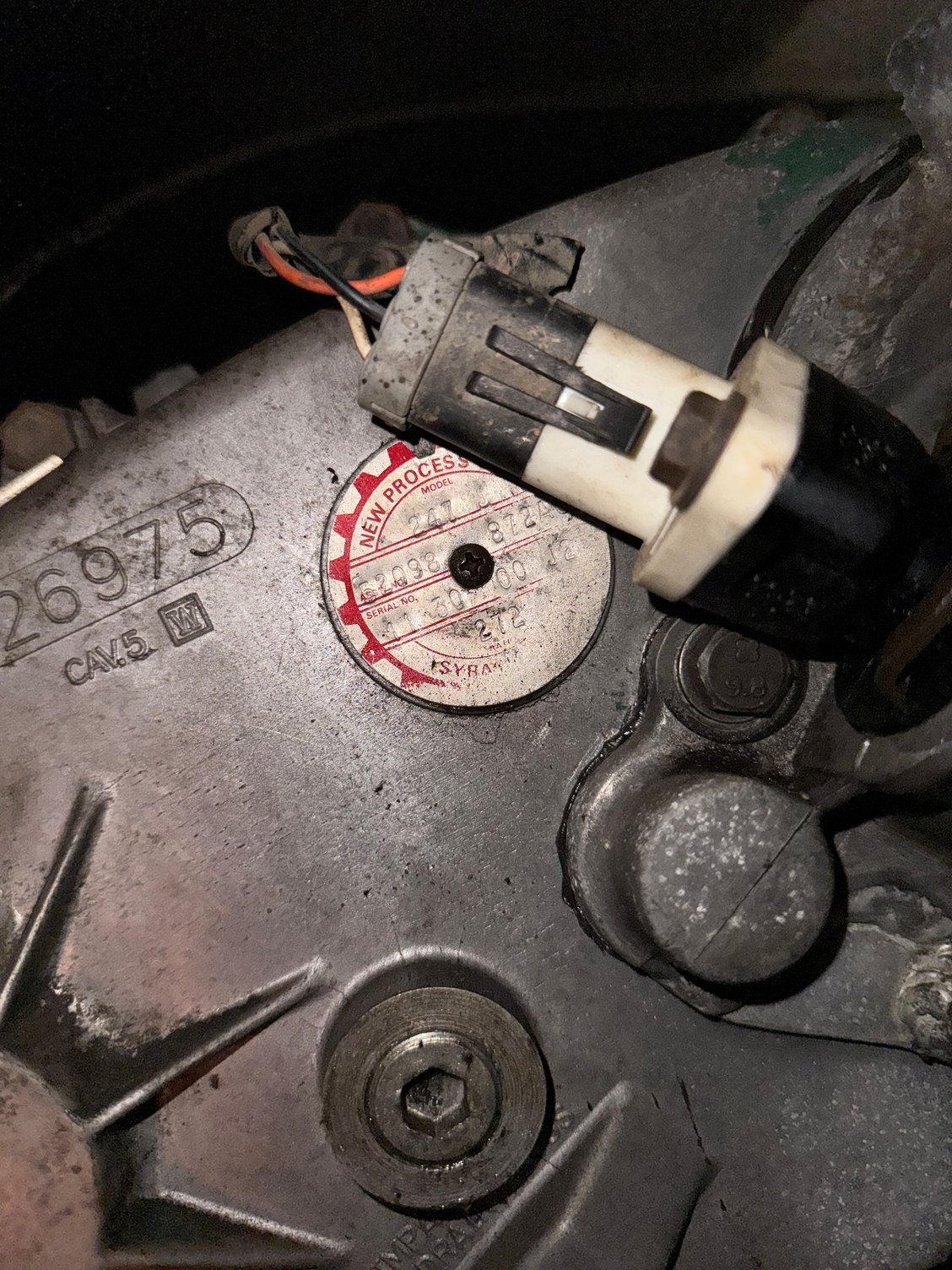

I took pictures of the transfer case and the tag.
You can also see some welding there.
Everything works fine and the shifter pattern is like original (2H,4H,N,4L).

Central axle disconnect. It's on the front axle.
Tag is held in with a screw, isn't that supposed to be a rivet??
247 is ostensibly and all wheel drive t-case...... It also utilizes a three position shifter..... 4 hi, (awd), Neutral, and 4 lo.
If you have the ranges advertised on your shifter, then your t-case just has the wrong tag on it.

You are probably right - it has just the wrong tag on it. Sometimes it is that simple
The CAD works but I will soon exchange it with a PosiLok because the previous owner messed up the hoses of the system.
At the moment you always have to manually connect two hoses together to activate the front axle (he wanted to use 4LOW without 4WD).
Thank you guys for the fast replies and all the information.
