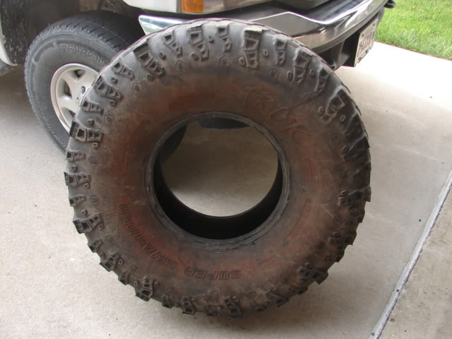

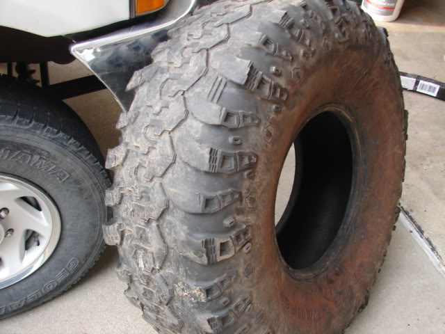

well i finally got my 10'' lift springs from whiplash suspension and i found some 39.5 x 13.5 x 16 IROK super swampers. ill be putting the springs on this week sometime. more pictures soon...

Holy hell those things have some arch to them.
Old Jun 12, 2011 | 07:59 PM
sk8erdude's Avatar
sk8erdude
Joined: Jan 2010
Posts: 316
From: Raonoke, IL
yeah their gonna ride like hell. lol
