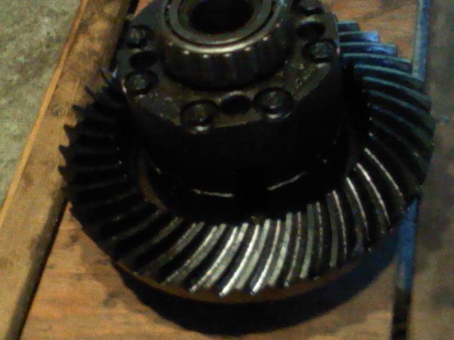

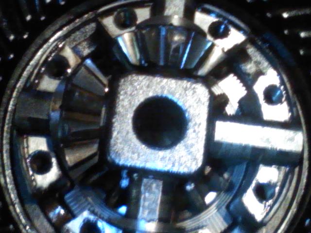

well i may be wrong but to me it looks like a locker, maybe its an after market one but it has a closed case and when i opened it it has 4 side spider gears instead of the LSD 2 side gears ill try to put a picture on here later
Old Jul 2, 2011 | 12:42 PM
1dodge123's Avatar
1dodge123
Joined: Jul 2011
Posts: 7
its missing the 2 spider gears that broke
