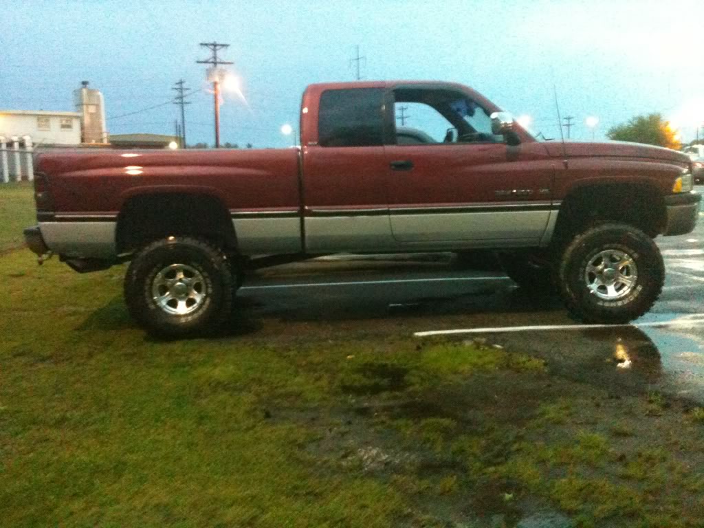

Side shot 7" on 35's. Ive never seen a 8" coil for a 1500, only a 7". You do not need an indexing ring if you have the right parts. Mine barely hit, I could've gotten away with just a little grinding but a guy I know used a couple different parts on the knuckle and I have yet to bind it. As long as you don't plan on literally jumping your truck I don't where spacers are a problem. It is very common to be done.
