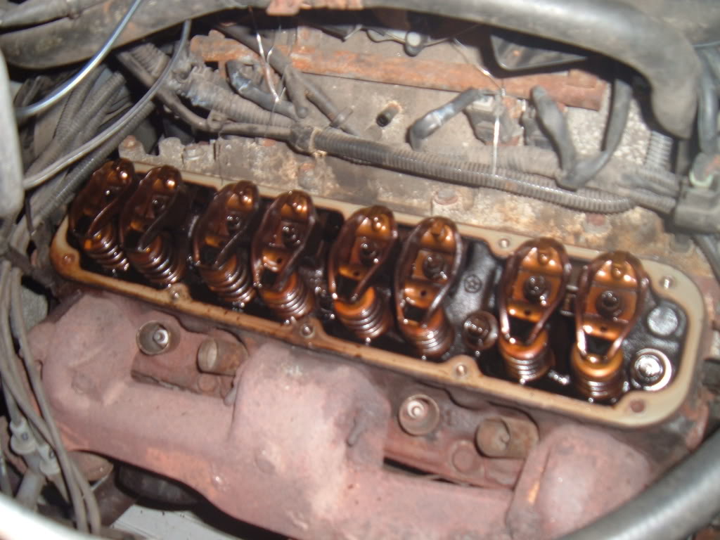

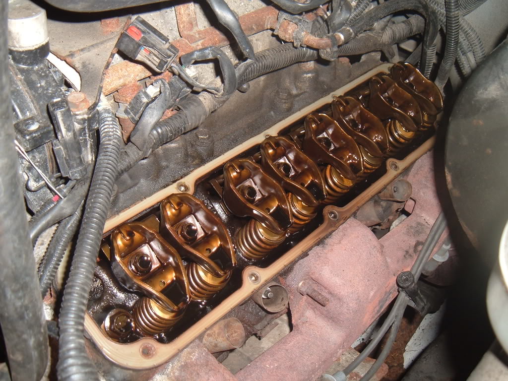

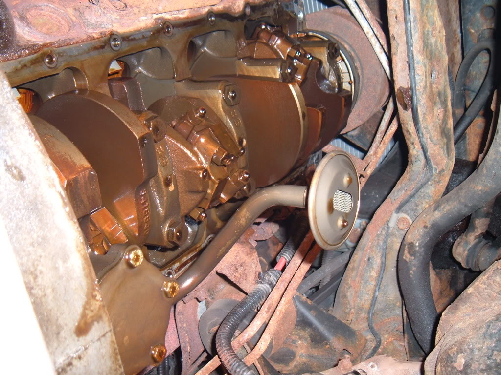

Ideally, this is how you'd like it to look as far as sludge and stuff. But the springs need a closer look.
