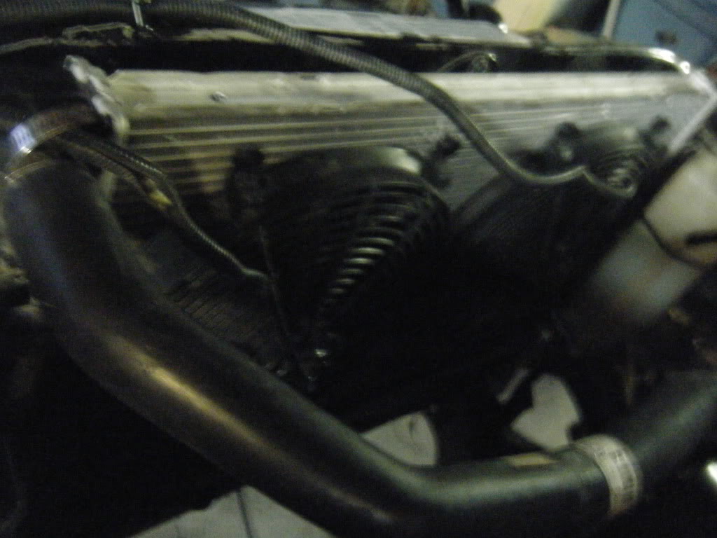

Got um Pulling w/o shroud. Im talking 20-25 degrees cooler just by removing the shroud. Do yall think my off road lights blocked that much air flow? All i did was remove the shroud and off road lights.

The entire cooling system is brand spanking new. Everything is wired properly, just removed my 3rd and 4th off road light from my grill and test drove it. 200* is where it stayed on the highway. As far as pic use your imagination. I'll bleed the system again tonight. Put it up on ramps. Ill take pics in a bit. Running peak 50/50 pre diluted.

running this now

was running this

these were in the way, at least the center two were.
