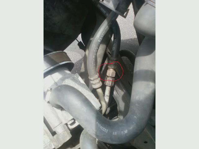

I think the check valve has already been deleted. I had the hose off to fix the tranny cooler radiator seal and saw no valve.

You need to post pics. Unless you have just a hose with some clamps the check valve is there.

Not that it's the problem you had but, "check valve"

i see I will remove said ball bearing today. I am leaning on the relay. Just because it fits. But will be serviceing the tranny and removeing the check valve.
