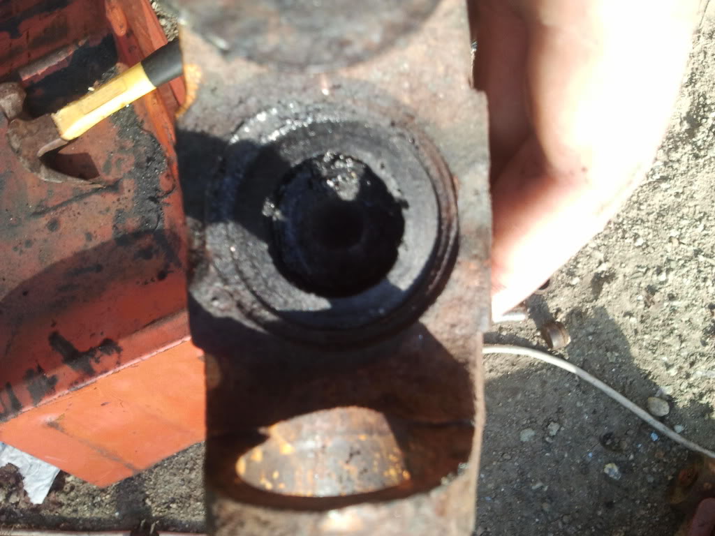

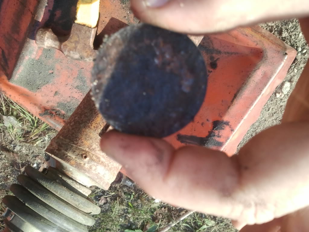

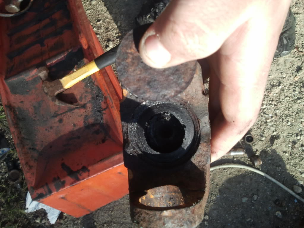

Hey guys, i finally picked up a new front drive shaft and i was taking the old u joint out and the cap that holds in the grease on the slip joint came off. Is there any special way to get this back on? Or is it a press fit and im screwed?

unfortunately no. here are some pics of what im talking about.

Your not pooched thats a dust/dirt plug, or welch plug. Get a new one from the drive shaft shop and use a hammer to seat it in.

well,no need to get a new one. got the old one back in, hadto takethe shaft apart. i took a small socket and wentaround the edges to seat it back into place! nowi just gotta getthe new ujoint in.....oh joy!

Before you get the cross joint in take a center punch and pean it in four places around the edge of the yoke part to help keep the plug in there.
