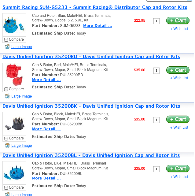

These are my options from summit:
Any preference? Does it matter?

Prolly the summit cap would be just fine.

If you don't have a significantly upgraded ignition system you don't need to get fancy with the cap and rotor -- any good quality, brass terminals setup will do.

I bought that first one when I did my tune up. That was 2 years ago and it is still running fine.

I have the summit xtreme cap and rotor and summit 8mm wires. Works good for me
