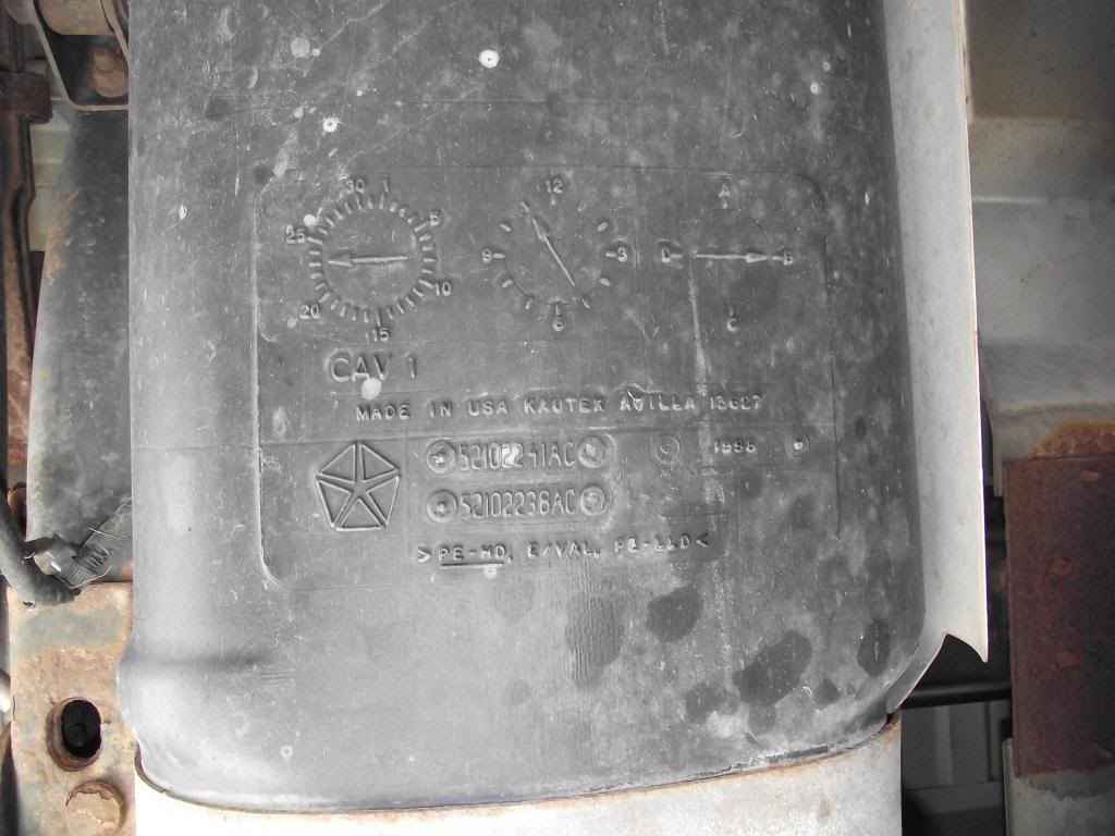

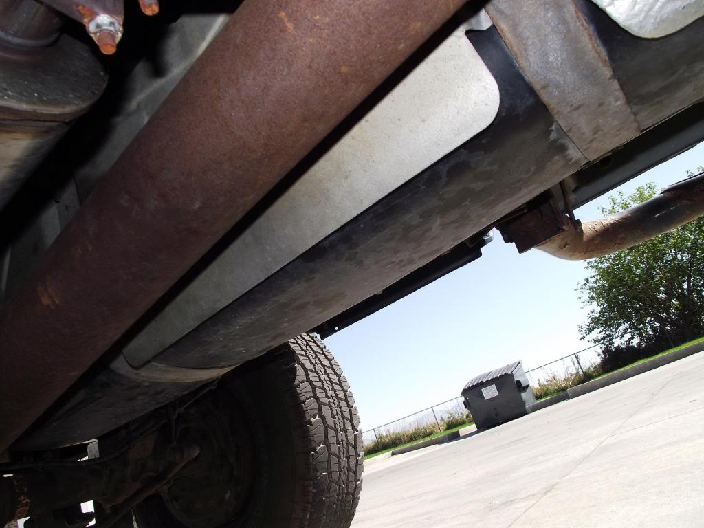

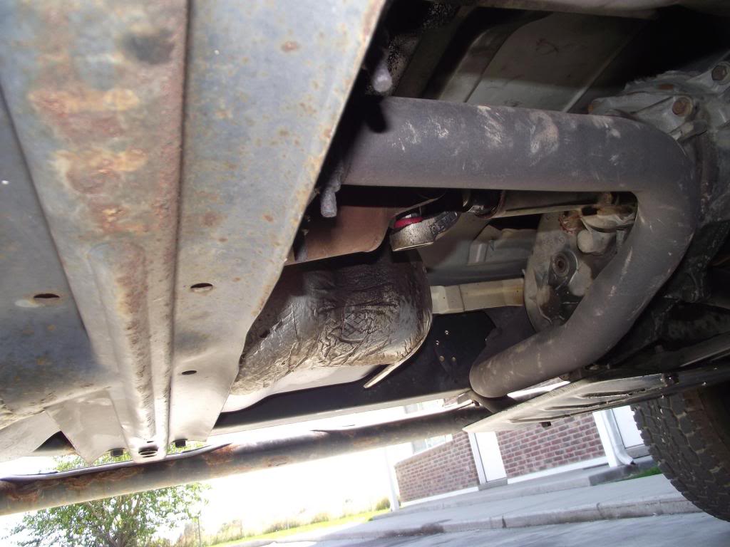

Ok, I was backward and off by a few cross members.....LOL......But that's what you get when you thinkin 50 miles away and a long time ago. The filler goes to the rear and the short end goes to the front, but yea there is plenty of room. Still, why would anyone want to install a 35 gal tank when you can just get a 34 gal tank and it will bolt right in? Just seems dumb....IMHO
Also looks like I have some painting to do.......

Not a problem there bud, That is what I was saying. The 35 gallon tank is not going to install. The 34 might.
