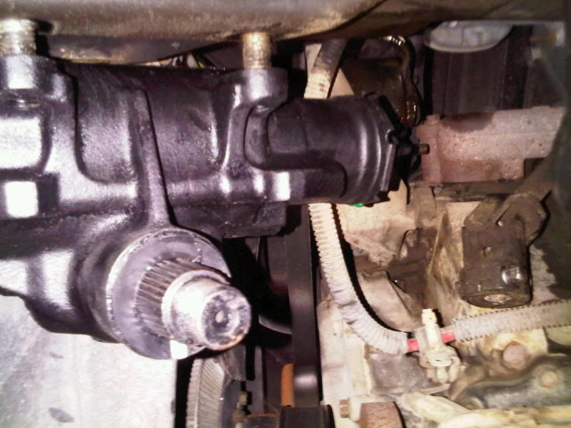

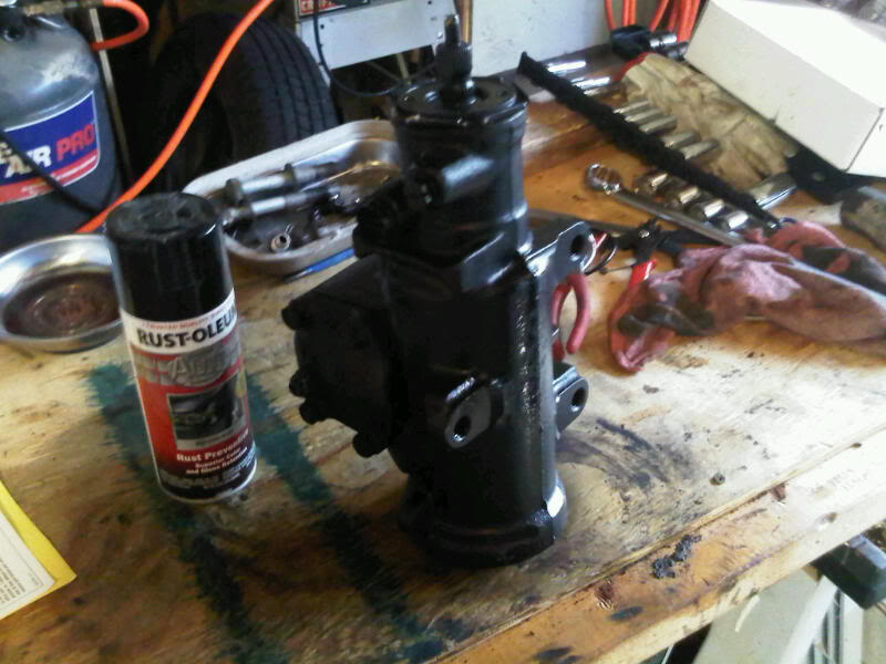

Got gearbox back together:
and bolting into place.
Gotta wait until Ranger game is over before I can get everything hooked up and change out pump.
