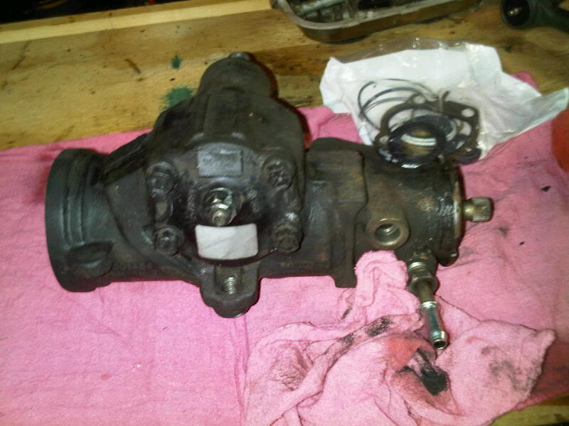

The Pitman shaft seals have been shot for some time, pump run dry more than once, and fluid that is in there looks like a mixture of trans fluid and motor oil.
So instead of just replacing seals, I am going to pull it all apart and clean, replace bearings and seals in gearbox, rebuild pump, and replace hoses.
Tie rod ends are shot also. Don't think they have seen a grease gun since it left the factory. Jounce bumpers and ball joints will be done also. This truck has lived a life of neglect.
Does anyone know what the diameter is of the Chrysler Special Tool C-4175 happens to be, or the major diameter of the worm shaft? I know that if I just pull it apart, I will have a bunch of little steel ***** scatter across the garage floor.

Does anyone know if there is a thread about this somewhere? I cannot find one but I did find a thread posted by VWandDodge from several years ago about pump rebuild.
Thanks!

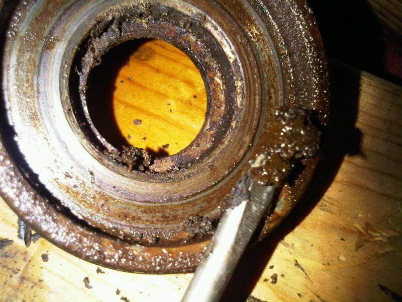

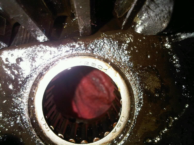

Got lucky. Doesn't happen very often. Bearing was installed as per FSM with part number facing inside, and rust and corrosion did not make it unreadable.
As you can see here, there are rust marks on pitman shaft from bearing.

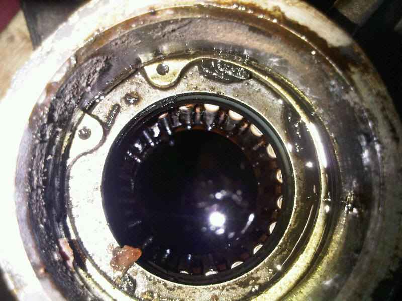

Lots of debris and dirt inside gearbox:

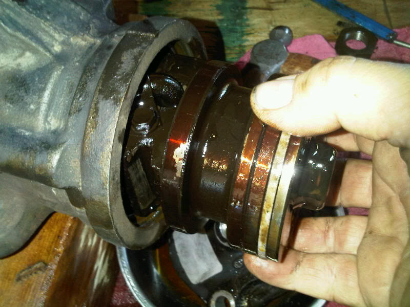

One thing - FSM is NOT a good reference to rebuild. It gives info for different repairs, but if you folllow their sequence, you WILL drop 24 little ***** (2 different sizes) onto the bench. If the pitman arm is remopved, you cannot take the end plug out of the rack piston end as it will rotate, freeing all of those little *****......gggrrrrrrrrrrrrrrrrrr........
Oh well, not a big deal. After seeing all of the rust and jonk, I needed to check worm very carefully and make sure the is not pitting in ***** or screw.
I will make a list of all bearings and seal ipart numbers and post in the event anyone else decides to do this as well.
