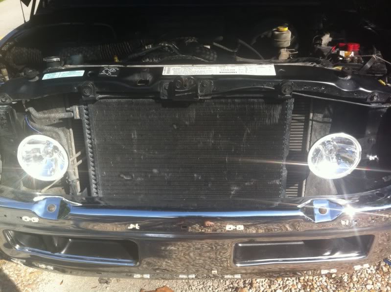

I installed these lights about 2 weeks ago and I love them. They put out a lot of light but I want more! Would it be bad if I put 2 lights in-between these two? I want to put two more 500ff's and they would fit but I'm worried about it restricting the airflow

Oh sorry about that, I'll try again. Ya they work amazingly well through the grill. With the hood up it doesn't put off too much more light but I like how they are hidden.

You can add two more, or pull the 55 watt bulbs and replace them with a couple H3 100 watt bulbs (about $5 each at any auto parts store), a lot easier and only 10 watts less total light output. Just make sure the wiring, fuses and relay are up to about a 17 AMP draw as oppose the the approximate 9 AMP draw you have now...

well those are the "driving lights" and I would think the "fog" light versions would be a nice compliment. Thats a good idea though, I will consider that or put hid's in them. So no one thinks it will cause a heat issue?

Nah, the 55 watt Hellas don't generate much heat at all. Funny thing is the 100 watt bulbs aren't much hotter but you put another brand of 100w lights behind the grill and they get HOT. Dunno what Hella does.
At 55 watts x 4, you'll only pull about 18 AMPs, so you can run them off the same relay if it's a standard 30 or 40A one. I'd just go 25A on any fuses if you do wire them all together. I've setup four Hella 500s on a couple of Jeeps for friends and had no problem running them all together and off one $5 relay. It's when you get up into multiple sets of 100W or greater lights you gotta start daisy chaining relays for one switch to work them all...

Well that's not too bad, I guess I'll just get two more and stick them in there. Thanks for the quick response!

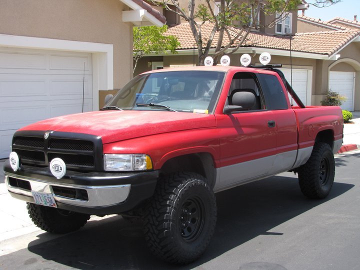

I've got a pair of Hella 500s on the brush guard. I had them laying around the garage for a year and when I bought the truck I knew where I could finally throw them-
