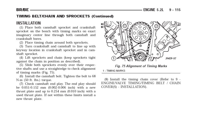

I am officially and totally confused .... and need to know for sure as I plan to install modified kegger, timing set, water pump....etc next week.
This is in the FSM located here on DF.
What I am reading is different from this. Did this change with a particular year model?
Thanks.
NO, that's the way he should have done it to begin with. Very simple. But he didn't do that. Another example of how reading a Haynes or downloading and reading the free manuals in the FAQ section has bit some one.
On a side note, PLEASE READ THIS THREAD, https://dodgeforum.com/forum/2nd-gen...e-tragedy.html
OK. I feel less confused. What was throwing me is the postings stating both gears should be "12 o'clock" when it should be crank at 12 o'clock and cam at 6 o'clock. Been that way on every vehicle I have ever worked on (well, except the DOHC Jaguar - and that's a different beast).
