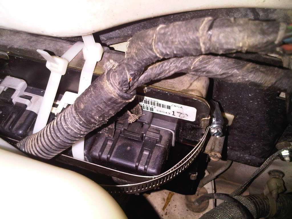

When I first picked up my Ram, I had no speed sensor, RAWL, and shifting issues. Took to local mechanic that found a bad wire to the PCM (don't know which one). He fixed it and it cured 2 of my problems.
I tend to agree with JohnD. Check all connectors at PCM. Check for chaffed or broken or loose wires. I resolved a similar issue on BIL Jeep GC by wrapping large hose clamp around PCM (seems to be a common issue on 96 era Grand Cherokees.) It displayed some of the same symptoms. I also wrapped a shielded mesh around cable assemblies to shield from emi.
