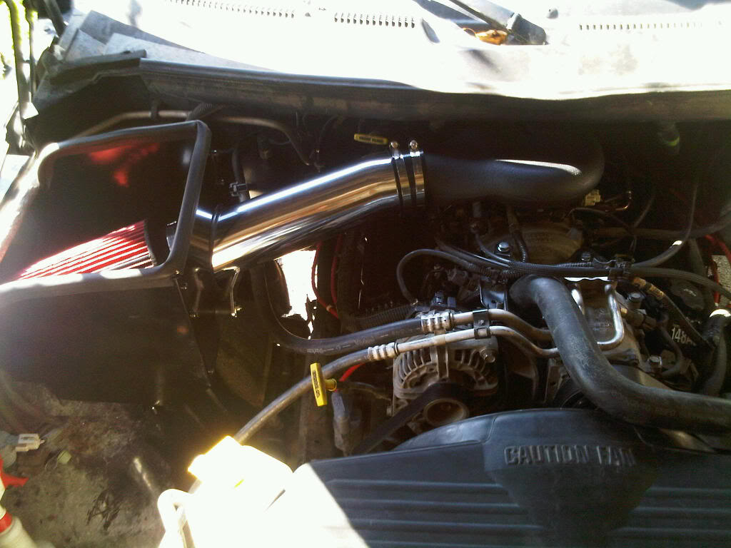

I installed a Spectre on mine this weekend. Been monitoring intake air temp. Plan to insulate outer part of intake box. Air under hood around town driving is 185 and air in box is running around 135 after about 20 minutes of driving. (It is in the 70's outside).
Don't know if CAI makes it run any better as I just did kegger mod, SCT tune and timing set, so too much change to be able to isolate anything.
