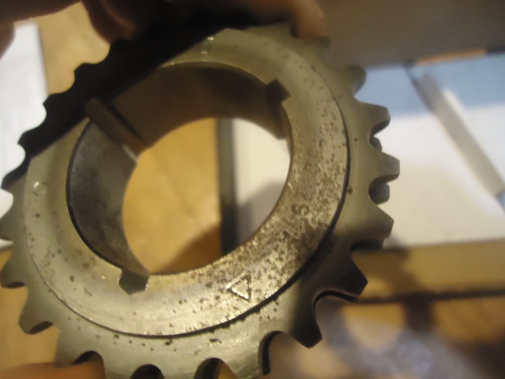

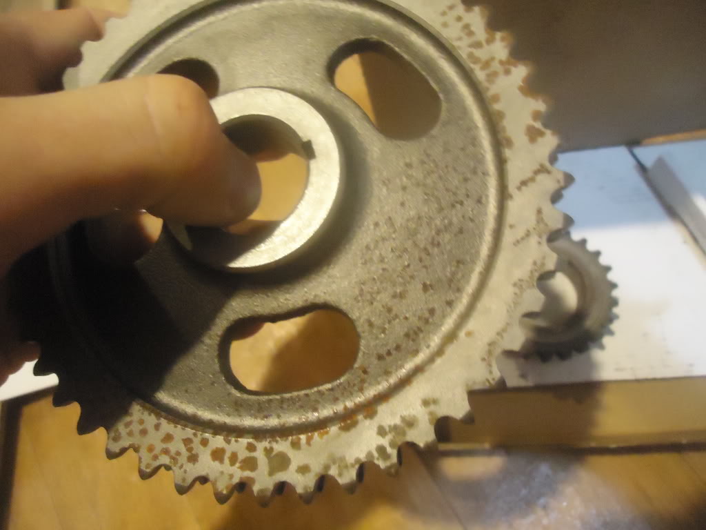

Sorry the chain was fine just the gears had it. heres some pics

also the small gear has a square a triangle and a circle and i understand the difference between those but i dint see anything on the big one but maybe its because the keyway only goes on one way huh?

Surface rust, it'll be arrested after the oil sloshes on it when you install it.
you can probably knock that light amount off with brake parts cleaner.

You can also use some steel wool to clean with brake or carb cleaner. Still soak chain in oil. Can't hurt it. It will take a little while for oil to get inside rollsers. Also, if the sprocket has no mark (check both sides) then I would suggest lining the marks up on then current timing set before removal. Install new set WITHOUT moving either the cam or crank.

the big gear has the word front printed on the front side and theres no notch or make anywhere on the front. also is it supposed to have the keyway or whatever or is it supposed to have the three or four holes like the pic in the link? hoping they sent the right one

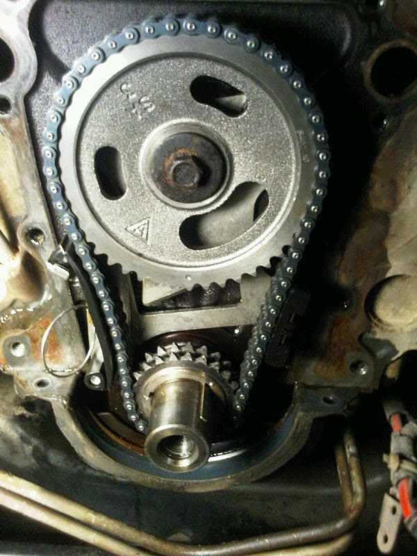

Depending on who manufactured it, they will look different. I still suggest lining up timing marks on old set before removal and not moving crank or cam. Install with the marked gear in correct position and make a mark on the other gear. Other option would be to return as defective as timing mark is not on gear. I got mine form Mopar Performance. The timing mark on crank is there, but does not show up on photo. Some of them have multiple keyways cut for some reason.
