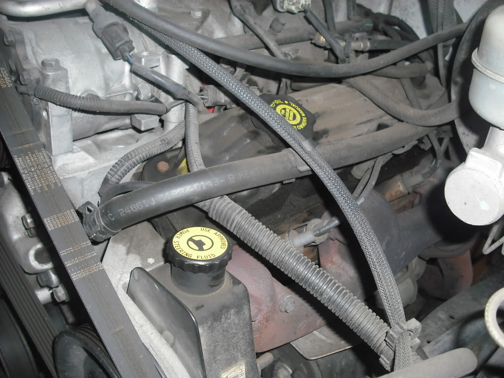

candymancan's description seems similar to me with respect to visual of my engine. Is this picture depict similar oil on the valve covers and the breather that you guys are speaking of?
My plan to address this was when I was going to replace my plenum. I have the kit, just haven't been able to schedule the time yet.

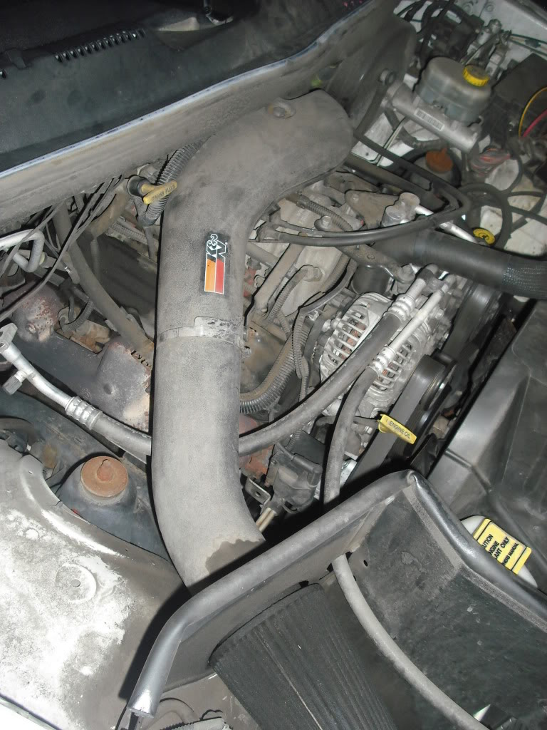

The crud on your snorkel behind the filter and the condition of the filter itself makes me wonder if the rubber air dam that's supposed to be beside your radiator is missing.

The bit I was referring to would be that hose that goes from the rear of your air hat to a valve cover -- the one that provides filtered air to the crankcase. If your PCV system is functioning as it should, oil would have to travel upwind and uphill to get into that hose, so oil in there usually indicates a failed PCV valve or a broken hose preventing the intake manifold from drawing air out of the crankcase.
As to the crud on the snorkel. That is actually from when I over did the re-oil of the filter. That is a picture now 3 months old. I had the tube replaced recently due to cracking up on top of the TB. There is no repeat of "crud" on that tube/snorkel now. However, the same dirty filter exists...as you've noticed previously.
Thanks for setting me straight about the air filter oil being the source of the cruds in your other photo.
