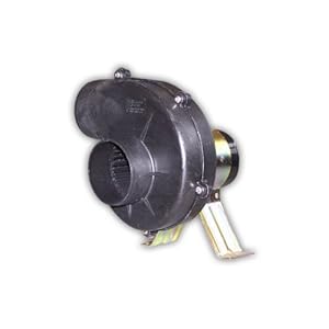

HERE IT IS!! THis is what I was researching: 1850 CFM, but 24 volt.
http://www.amazon.com/Jabsco-36740-0.../dp/B000O8BAE8
Would that work? Probably, but you would need a world class charging system.

That would not work, CFM means little for this application, it wouldn't build enough pressure.
If a electronic supercharger worked efficiently, it would be done already. Building a real turbo system would be cheap if the right parts could be sourced.
$100 for headers $28 T4 flanges, then you just need to source the turbos, waste gates and plumbing.
http://www.ebay.com/itm/T-304-STAINL...item415d69f7ea

Correct, sure it can move a lot of air, but it won't do it under pressure. Electric supercharging is possible, it's just not feasible.
And lol @ turboing for cheap, trust me, it's not.

from everything I've read, Hans is dead on..
there may come a day when it is practical, but it isn't now.. it goes back to the volume/pressure thing.. electric can give you one or the other, but not both..
I'm still of the opinion that the gains witnessed on a dyno using those leaf blowers, or the like, aren't the effects of boost... they are instead the effects of eliminating resistance of air flow.. Boost crams air in the chamber, as in- under pressure before the pistons start compressing.. eliminating resistance is just that- allowing the engine to ingest the volume of air it wants to ingest instead of what it can ingest..
