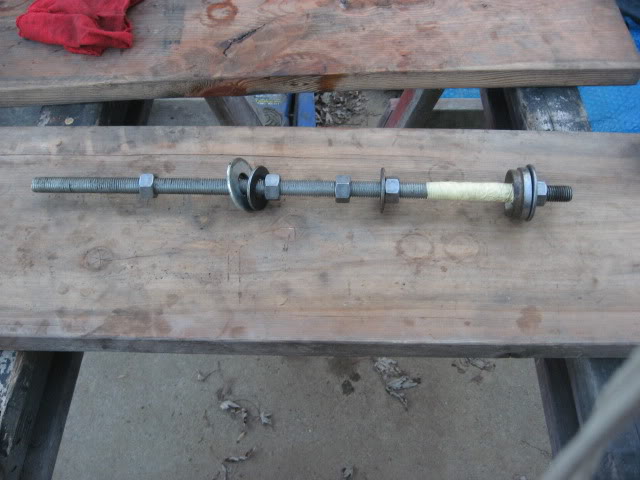

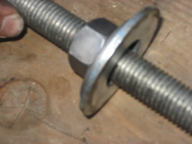

just some pictures of the tool I used to put the seal in and the locker in the case.
I used the washer as a puller to pull on the seal even

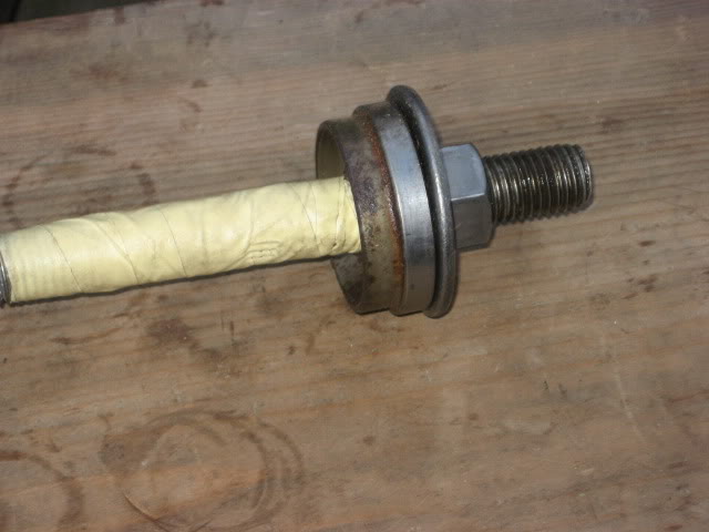

This washer and nut went on the outside of the axle tube to work as a press

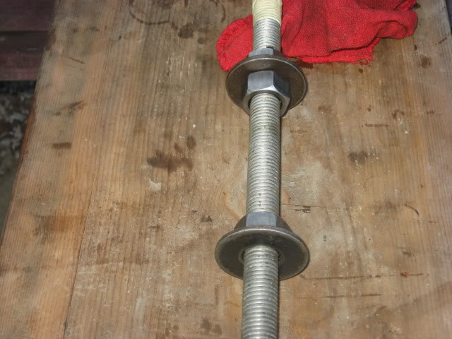

The two sets of washers and nuts in the middle were used to keep the rod centered in the axle tube.

Just a wide shot of the whole thing
