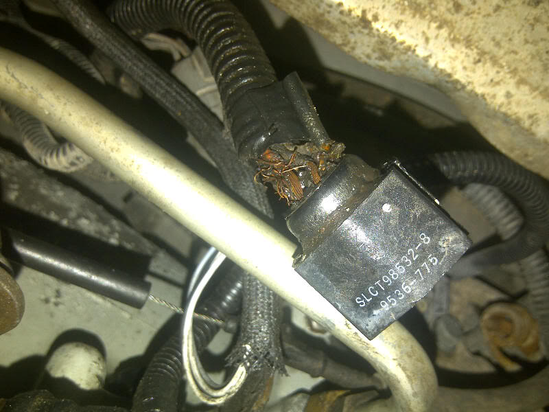

Of course there is also this on the exterior. If that's what you were talking about.
