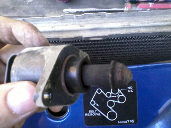

this is my IAC, this is the cleanest it will get. I used the TB and carb cleaner. I did my best.
-If I can keep the truck running by applying gas, that wouldn't have anything to do with a Fuel Pump would it?
Should I replace IAC or would it even matter?
I'm not very smart on vehicles, but I'm learning.
It'd be an indication that the pump is working, at least to some extent. I'd put a fuel pressure test gauge to it just to be sure.
Looking like that? Yeah, I'd replace it.
A sticking IAC can definitely cause your engine to die at idle. It's the most commonly complained of symptom when an IAC fails.
Alright, I will be replacing it soon.
Are there any other sensors that I should look at if it needs to be replaced

Alright, I just purchased a IAC I will be replacing it thursday, I will see if that fixes my issue.
