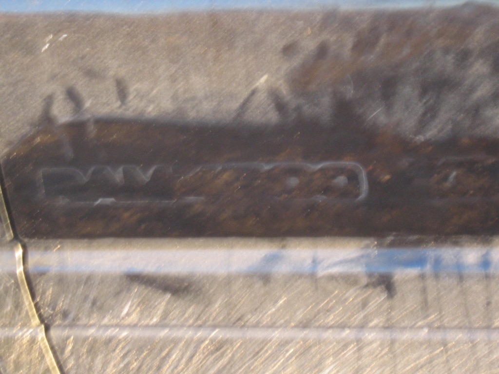

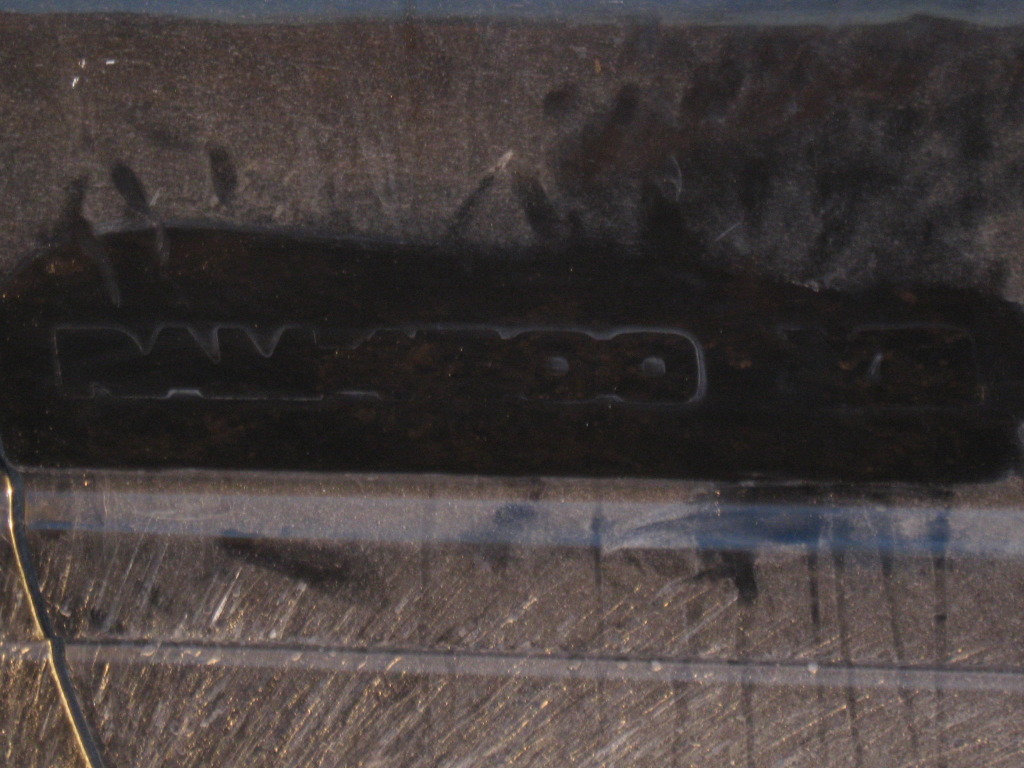

I debadged my 2000 dodge ram today but there is still like a white outline? Is it oxydation? Fade? How do I get rid of it?

Get an 'eraser' wheel from the parts store. "Mothers" brand is the best. Chuck it up in a drill, and make that stuff go away. Careful though, possible to burn paint with it too...

I would give this product a try, I use their line of products nice stuff.
